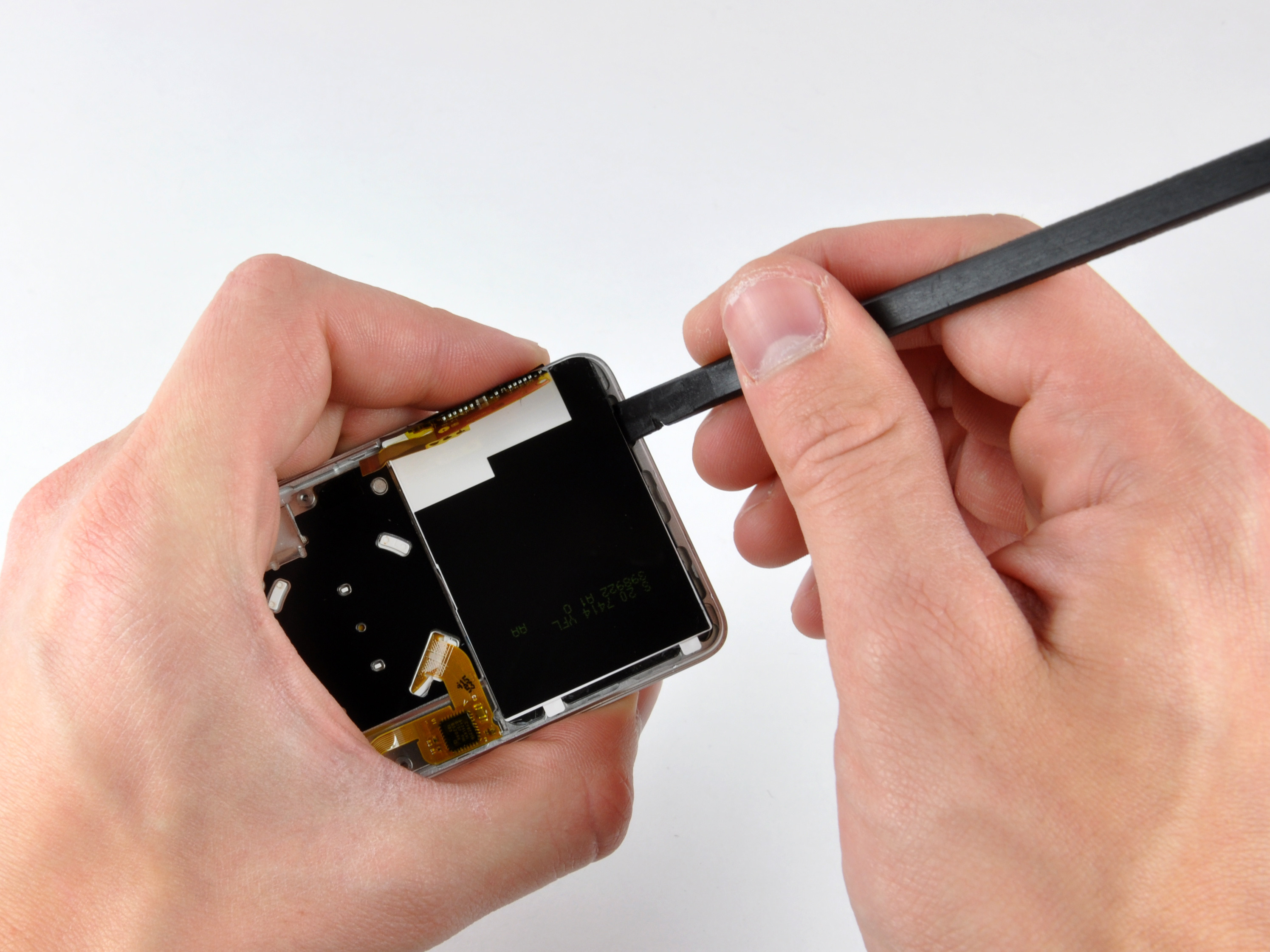

  14. iPod Nano 3rd Generation Display Replacement, Display: step 14, image 1 of 1
    • A layer of adhesive around the perimeter of the display holds it securely to the front case. The following steps require prying up on the display with a spudger to free it from the adhesive.
    • The display is inherently delicate due to its thin glass construction. In the next few steps it is essential to work slowly and gently while prying the display from the front case.
    • Insert a spudger in the gap between the front case and the display near the top right corner. Slowly and gently pry the display up at several points along the top edge of the display, working your way toward the left corner.
  15. iPod Nano 3rd Generation Display Replacement: step 15, image 1 of 1
    • Continue prying up slowly and gently on the display, this time starting at the top right corner and working your way down the right side.
    • Repeat this procedure on the left side of the display, working down from the top left corner.

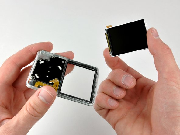

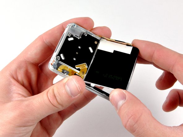

  16. iPod Nano 3rd Generation Display Replacement: step 16, image 1 of 2 iPod Nano 3rd Generation Display Replacement: step 16, image 2 of 2
    • When the adhesive has yielded enough to create a gap large enough to fit your fingers between the display and the front case, lift the display and gently peel off the remaining adhesive to remove it from the front case.
    • Display remains.
