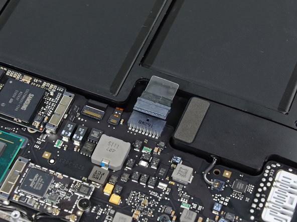

    1. MacBook Air 13" Mid 2011 Battery Replacement, Battery: step 3, image 1 of 2 MacBook Air 13" Mid 2011 Battery Replacement, Battery: step 3, image 2 of 2
      • Grab the clear plastic pull tab attached to the battery connector and pull it toward the front edge of the Air to disconnect the battery from the logic board.
      • Do not lift upward on the connector as you disconnect it.
      • When reinstalling a new battery, it may be helpful to temporarily reconnect the battery before placing it in the frame. Make sure that the connector lays flat to the board.
      Ask FixBot
