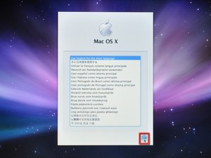

      • Your Mac will begin copying the installation files from the flash drive. This may take up to 30 minutes.
      • Depending on the speed of your flash drive, it may look like progress has frozen, but it should resume if you continue to wait.
      • When prompted, select your language and press [enter], or click the arrow button.

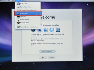

      • If you don't need to pre-configure your hard drive, skip to step 5. If you're not sure or if the drive is used, it's a good idea to pre-configure your hard drive.
      • Select "Disk Utility" from the menu and press [enter] or click the continue button.

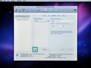

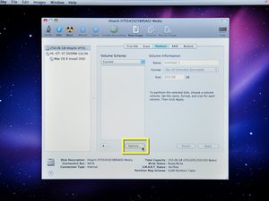

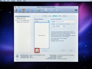

      • Select your hard drive from the left column in Disk Utility.
      • It is most likely the uninitialized drive.
      • If you have multiple hard drives, make sure you select the correct one as the next step will wipe the selected drive clean.
      • Click the "Erase" button at the top of the window.
      • Choose a name for your drive (you can rename it later). Leave the scheme as GUID Partition Map.
      • If you are installing an SSD, choose the APFS format. If you are installing a mechanical drive or if your device doesn't officially support the newer OS, leave the format as Mac OS Extended (journaled)
      • Click "Erase." When the process completes, click "Done."
      • Exit the Disk Utility by clicking on the red X button on the top left corner of the window.

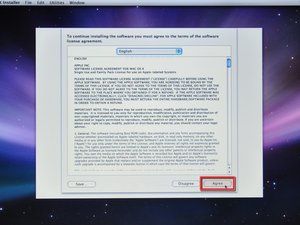

      • Read through the license agreement.
      • Click "Agree" to accept the license agreement.
      • Your Mac will now install macOS High Sierra. Be patient and wait for it to complete.
      • Once the install is complete, the device will restart itself.
