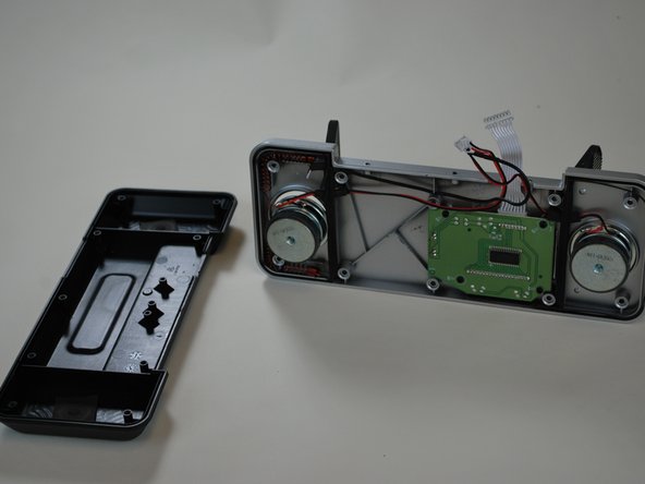

    5. Insignia NS-CLIP02 Digital Display Replacement: step 5, image 1 of 1
      • Remove the bottom cover from the device to reveal the motherboard.
      Ask FixBot
    6. Insignia NS-CLIP02 Digital Display Replacement: step 6, image 1 of 1
      • Use a Phillips screwdriver to remove the 9.5 mm screw located near the center of the motherboard.
      Ask FixBot
    7. Insignia NS-CLIP02 Digital Display Replacement: step 7, image 1 of 1
      • Lift the motherboard away from the device.
      Ask FixBot

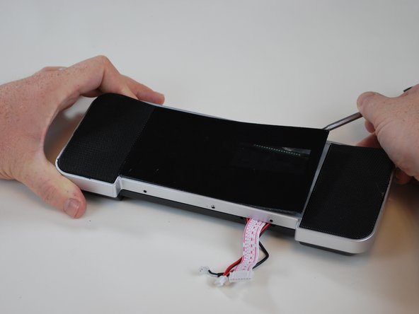

    3. Insignia NS-CLIP02 Digital Display Replacement: step 11, image 1 of 2 Insignia NS-CLIP02 Digital Display Replacement: step 11, image 2 of 2
      • Using the metal spudger, gently lift the face plate away from the display.
      Ask FixBot

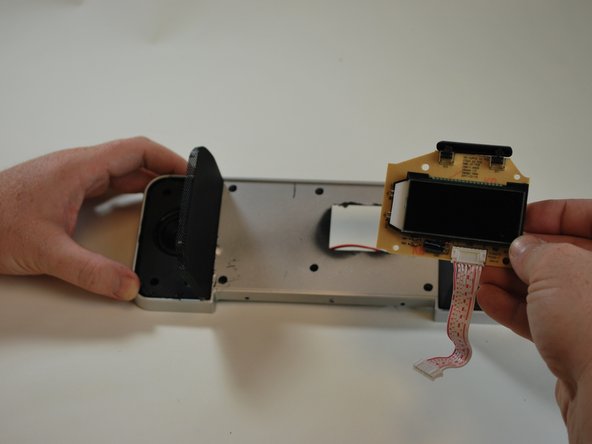

    8. Insignia NS-CLIP02 Digital Display Replacement: step 16, image 1 of 1
      • Using the Phillips screwdriver, remove the three screws shown here.
      Ask FixBot
    9. Insignia NS-CLIP02 Digital Display Replacement: step 17, image 1 of 3 Insignia NS-CLIP02 Digital Display Replacement: step 17, image 2 of 3 Insignia NS-CLIP02 Digital Display Replacement: step 17, image 3 of 3
      • The digital display should now be easy to remove.
      • Replace with new part.
