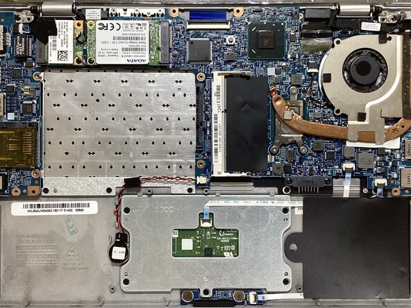

    1. Improving Laptop Cooling, Heat sink removal: step 6, image 1 of 1
      • After separating the back panel, you should see copper pipes (heat pipes). These are called the heat sink. There are three screws near the tip on the side without the large fan.
      • Remove those screws using a Phillips #0 screwdriver.
      • Once the screws are removed, carefully lift the heat sink.
      • Copper is a very soft material. Rough handling can cause damage to the heat sink.
      Ask FixBot
      • Once you have completed the removal of the heat sink, you will see the part of the CPU called the die. It may be covered in hard, dried-out thermal paste.
      • Wipe away the old thermal paste.
      • We recommend using a lint-free, non-conductive cloth dampened with anhydrous ethanol to wipe away the thermal paste.
      • Remove the old thermal paste from the heat sink side as well.
      Ask FixBot
