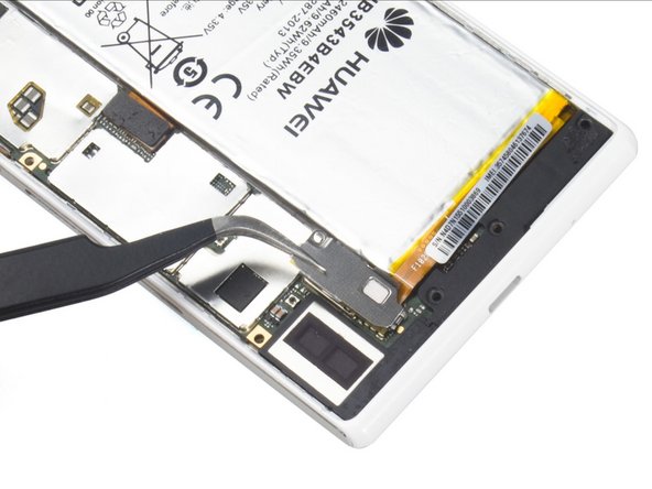

  4. Huawei Phone p7 Loudspeaker Replacement: step 4, image 1 of 3 Huawei Phone p7 Loudspeaker Replacement: step 4, image 2 of 3 Huawei Phone p7 Loudspeaker Replacement: step 4, image 3 of 3
    • Remove 3 pieces of securing brackets.
