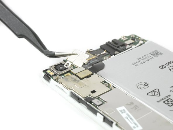

      • Remove the Phillips #00 screw that holds down the metal clamp covering the front camera connector.
      • Remove the metal clamp covering the flex connector of the front camera.
