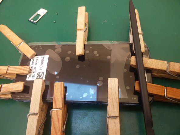

  3. Huawei Nova 2 LCD Display + Touchscreen + Frame switch, Loosen display: step 3, image 1 of 2 Huawei Nova 2 LCD Display + Touchscreen + Frame switch, Loosen display: step 3, image 2 of 2
    • Start by heating the screen to make the glue soft and smooth. The glued areas are the upper corners, around the ear speaker and thin glue strips on the sides. The most glued zone is the bottom: almost the entire black bottom with the Huawei logo is glued.
    • In this example I tried to lift the display too quickly and the LCD was damaged by the already splintered underside. No extra profit to be made for this repair via sale of a broken screen: (

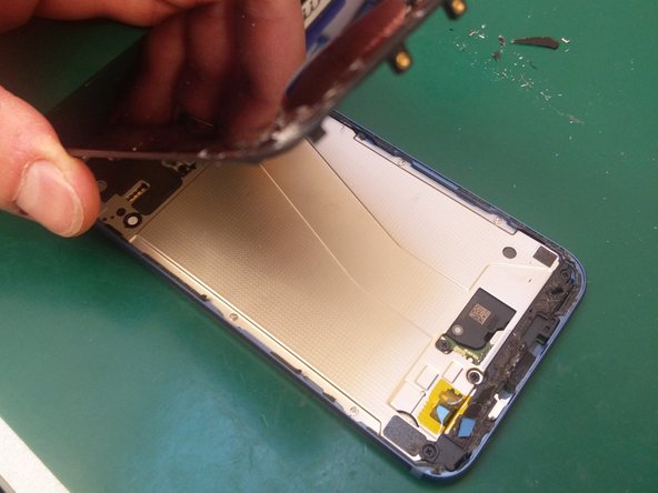

  4. Huawei Nova 2 LCD Display + Touchscreen + Frame switch, Tilt the screen: step 4, image 1 of 1
    • After all the glue has been successfully cut using a pick or plastic card / playing card, you can carefully tilt the screen. Hold the top approximately in position and lift the bottom (see image). If resistance is encountered, the screen must also be heated up.
    • The screen opens in a similar way to the iPhone 5/6 series.

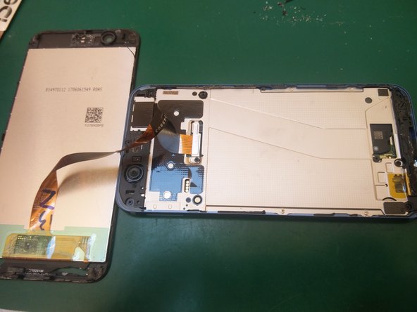

  5. Huawei Nova 2 LCD Display + Touchscreen + Frame switch, Unscrew the cover plate: step 5, image 1 of 2 Huawei Nova 2 LCD Display + Touchscreen + Frame switch, Unscrew the cover plate: step 5, image 2 of 2
    • Now the display can be placed next to the device. Make sure that there are no excessive tensile forces or stresses on the connecting cable. Remove the Philips screw that holds the cover in place.
  6. Huawei Nova 2 LCD Display + Touchscreen + Frame switch, Disconnect battery and screen: step 6, image 1 of 2 Huawei Nova 2 LCD Display + Touchscreen + Frame switch, Disconnect battery and screen: step 6, image 2 of 2
    • Start by disconnecting the battery connector using a plastic spatula. It is always a good practice to disconnect the battery as soon as possible when carrying out a repair.
    • Then disconnect the screen connector.

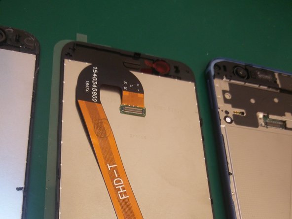

  7. Huawei Nova 2 LCD Display + Touchscreen + Frame switch, Compare old and new screen: step 7, image 1 of 2 Huawei Nova 2 LCD Display + Touchscreen + Frame switch, Compare old and new screen: step 7, image 2 of 2
    • Carefully compare the old with the new screen and make sure that all protective films and stickers are removed (possibly after testing the screen). For example, I had a red stick on the camera fitting for protection against scratches and dirt.
    • This is also an ideal time to carefully study and remember all glued areas.

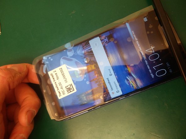

    • First, click the screen connector back in. The battery connector can then be reconnected and the screen can be tested before gluing the screen.
