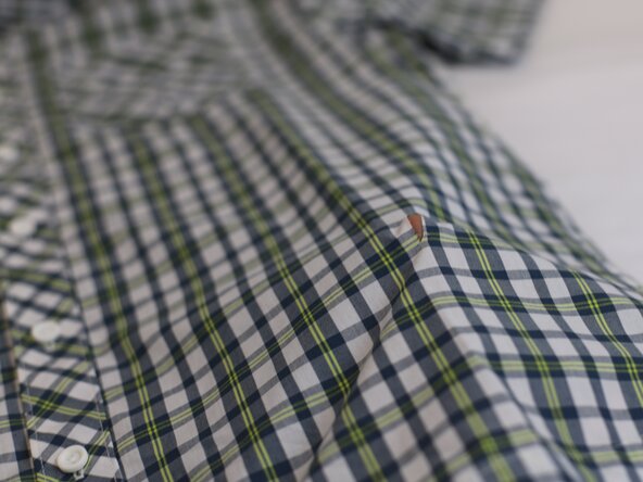

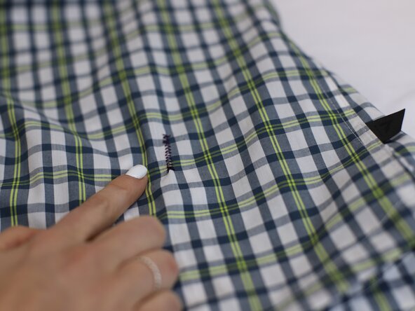

  1. How to repair a hole in woven textile (using a sewing machine), Identify the Hole: step 1, image 1 of 3 How to repair a hole in woven textile (using a sewing machine), Identify the Hole: step 1, image 2 of 3 How to repair a hole in woven textile (using a sewing machine), Identify the Hole: step 1, image 3 of 3
    • Identify the part of the t-shirt that needs repairing and gather all the necessary tools.

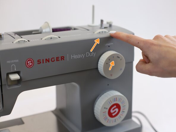

  2. How to repair a hole in woven textile (using a sewing machine), Set up the sewing machine: step 2, image 1 of 2 How to repair a hole in woven textile (using a sewing machine), Set up the sewing machine: step 2, image 2 of 2
    • Adjust the sewing machine to the Zig-Zag stitch setting
    • Set it to a medium length (around 2.0 to 3.0 mm) for a balanced stitch.
    • Tip: Use the iFixit resources for setting up a sewing machine, and practicing basic stitch techniques on some scrap fabric first.

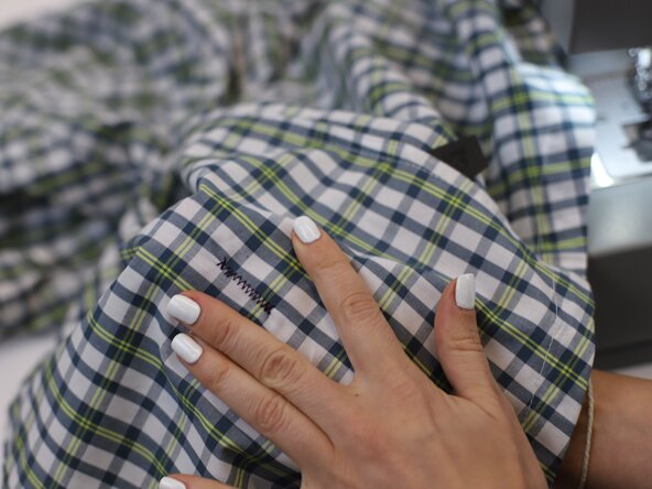

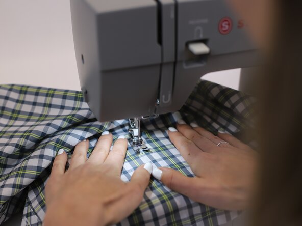

  3. How to repair a hole in woven textile (using a sewing machine), Use the Sewing Machine to Fix the Hole: step 3, image 1 of 3 How to repair a hole in woven textile (using a sewing machine), Use the Sewing Machine to Fix the Hole: step 3, image 2 of 3 How to repair a hole in woven textile (using a sewing machine), Use the Sewing Machine to Fix the Hole: step 3, image 3 of 3
    • Carefully position one end of the repair under the needle. The fabric needs to be flat before sewing.
    • Make a locking stitch using the reverse lever, then sew a single stitch along the length of the seam.
    • Secure the stitch with another lock stitch at the end.
    • Tip: Make sure that there's only one layer under the sewing machine. Depending on the fabric, repeat the stitch 1-2 times if needed for extra durability.

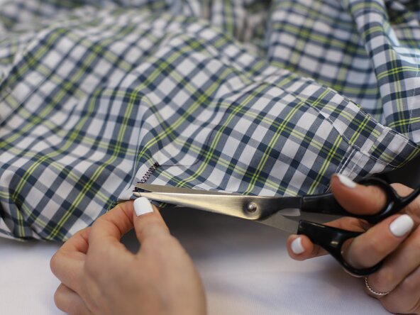

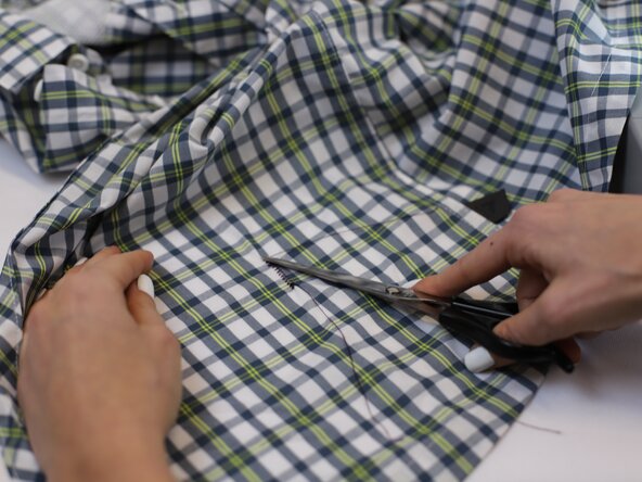

  4. How to repair a hole in woven textile (using a sewing machine), Clean the area: step 4, image 1 of 3 How to repair a hole in woven textile (using a sewing machine), Clean the area: step 4, image 2 of 3 How to repair a hole in woven textile (using a sewing machine), Clean the area: step 4, image 3 of 3
    • Remove the shirt from the sewing machine and inspect the repair. The old edges may be uneven, but the new stitch should look secure and well-fastened on both ends.
    • Use a pair of scissors to cut any loose threads.
