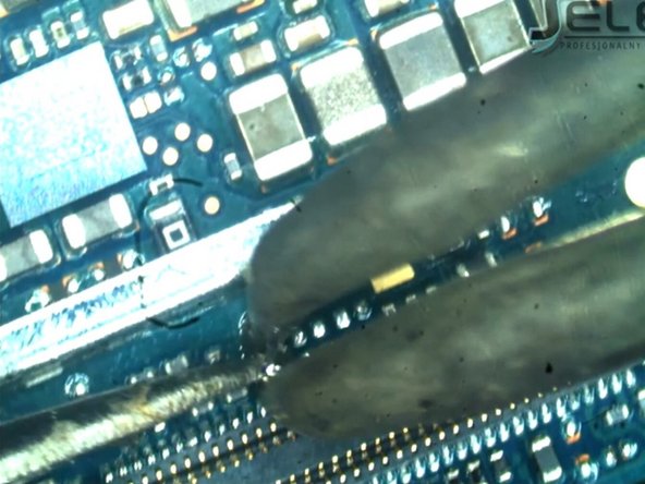

    • Visually inspect the logic board.
    • This logic board is missing filters, which were likely damaged when the user attempted to replace the phone's display.
  9. How to fix no image/black screen issue in Sony Xperia Z3: step 9, image 1 of 3 How to fix no image/black screen issue in Sony Xperia Z3: step 9, image 2 of 3 How to fix no image/black screen issue in Sony Xperia Z3: step 9, image 3 of 3
    Tool used on this step:
    Buy
    • Apply a small amount of flux to the motherboard's filters.
    • In micro-soldering, flux prepares the metal surfaces of the logic board by cleaning and removing impurities.
    • Wait at least 30 seconds for the flux to clean the surfaces.
    • Use a pair of micro-soldering tweezers to remove the metal square from the filters.
  10. How to fix no image/black screen issue in Sony Xperia Z3: step 10, image 1 of 3 How to fix no image/black screen issue in Sony Xperia Z3: step 10, image 2 of 3 How to fix no image/black screen issue in Sony Xperia Z3: step 10, image 3 of 3

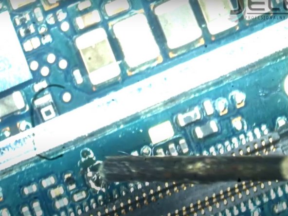

    • Apply solder to each of the three sets of four pins now exposed on the logic board.
    • After each solder, apply a small amount of flux to the new connection to clean the connection.
    • Be sure to wait at least 30 seconds after applying the flux so that it can clean and remove impurities.
  11. How to fix no image/black screen issue in Sony Xperia Z3: step 11, image 1 of 2 How to fix no image/black screen issue in Sony Xperia Z3: step 11, image 2 of 2
    • Check that each of the connections covers all four of the pins in each set.
    • Re-form the solder or add additional solder if the connection does not cover all four pins.
