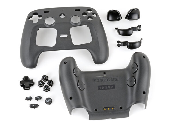

    3. How to Reshell Your Steam Controller (2nd Generation), Remove the button membranes: step 31, image 1 of 3 How to Reshell Your Steam Controller (2nd Generation), Remove the button membranes: step 31, image 2 of 3 How to Reshell Your Steam Controller (2nd Generation), Remove the button membranes: step 31, image 3 of 3
      • Remove the four silicone button membranes.
      Ask FixBot
    4. How to Reshell Your Steam Controller (2nd Generation), Remove the buttons: step 32, image 1 of 3 How to Reshell Your Steam Controller (2nd Generation), Remove the buttons: step 32, image 2 of 3 How to Reshell Your Steam Controller (2nd Generation), Remove the buttons: step 32, image 3 of 3
      • Use tweezers to remove the D‑Pad, View, Steam, Menu, ABXY, and Quick Access Menu buttons.
      • Alternatively, you can flip the front case over and let the buttons fall out.
      • During reassembly, use the alignment tabs to orient each button in its recess. Each one is keyed for proper location and orientation.
      Ask FixBot
    5. How to Reshell Your Steam Controller (2nd Generation), Remove the button dampeners: step 33, image 1 of 3 How to Reshell Your Steam Controller (2nd Generation), Remove the button dampeners: step 33, image 2 of 3 How to Reshell Your Steam Controller (2nd Generation), Remove the button dampeners: step 33, image 3 of 3
      • Use tweezers or a spudger to remove all the button dampeners (they surround the button recesses) from the front shell.
      • During reassembly, transfer the dampeners to your new shell. Use a spudger to push them down so they're fully seated against the shell.
      Ask FixBot
    1. How to Reshell Your Steam Controller (2nd Generation), Disassembly complete: step 34, image 1 of 1
      • Congratulations on fully disassembling your Steam Controller! During reassembly, you'll need to transfer all the controller's internals into your replacement shells.
      Ask FixBot

Rene Jacobsen - Reply Share
Do you have any pictures of the inside of the rear shell? I want to see how the back buttons work.
PepsiManX360 - Reply Share
@pepsimanx360 and @renejacobsen Here's a link to a photo of the back cover!
Spencer Day - Reply Share
@spencerd Thank you so much! It’s so cool! I was wondering how the rear buttons worked.
