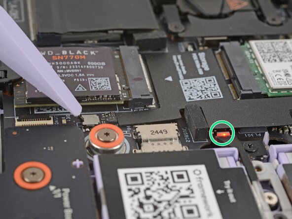

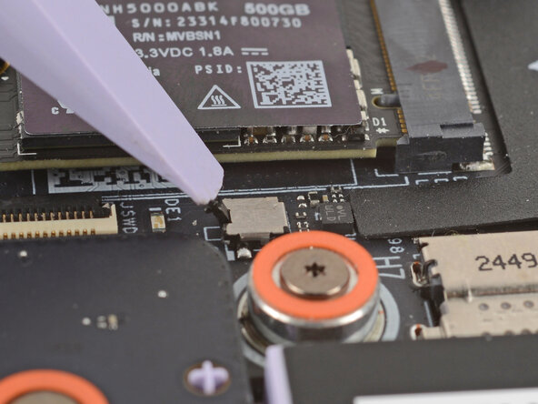

  8. How to Reset the Mainboard in your Framework Laptop 12, Locate the chassis open switch: step 8, image 1 of 2 How to Reset the Mainboard in your Framework Laptop 12, Locate the chassis open switch: step 8, image 2 of 2
    • Locate the chassis open switch to the right of the SSD slot.
    • This switch is a sensor that detects if the Top Cover has been removed. It's a small silver block with a black toggle tab.
  9. How to Reset the Mainboard in your Framework Laptop 12, Press the switch: step 9, image 1 of 3 How to Reset the Mainboard in your Framework Laptop 12, Press the switch: step 9, image 2 of 3 How to Reset the Mainboard in your Framework Laptop 12, Press the switch: step 9, image 3 of 3
    • Use your finger or the flat end of a Framework Screwdriver to press the chassis open switch 10 times:
    • Press and hold the switch down for two seconds.
    • Release the switch and wait for the indicator LED to resume blinking.
    • Repeat the process 10 times total.
