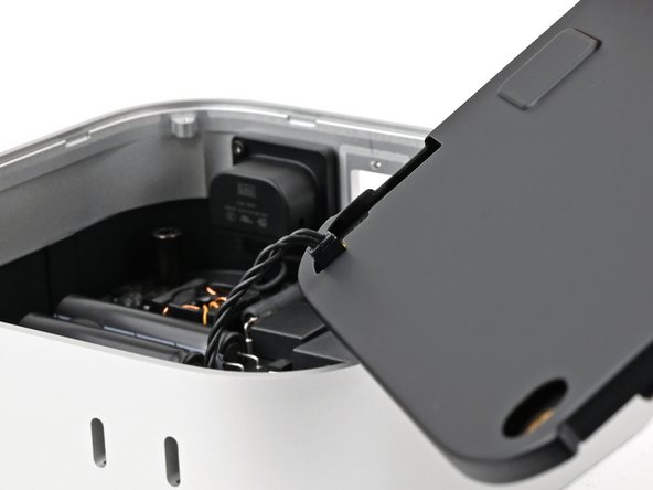

  7. How to Replace the Thermal Paste in your Mac mini (2024), Disconnect the power button: step 7, image 1 of 2 How to Replace the Thermal Paste in your Mac mini (2024), Disconnect the power button: step 7, image 2 of 2
    • The power button cable is very fragile! You don't have to disconnect it to access the internals— but it will require you to keep the bottom cover propped up.
    • To disconnect the cable and remove the bottom cover, follow the next two steps.
    • If you don't disconnect the cable, prop up the bottom cover to prevent straining the cable and skip the next two steps.
    • Grip the power button cable close to the head and pull it away from its socket to disconnect it.
  8. How to Replace the Thermal Paste in your Mac mini (2024), Remove the bottom cover: step 8, image 1 of 1
    • Remove the bottom cover.

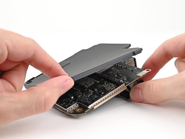

  11. How to Replace the Thermal Paste in your Mac mini (2024): step 11, image 1 of 2 How to Replace the Thermal Paste in your Mac mini (2024): step 11, image 2 of 2
    • Pull the inner plate away from the chassis to slide it out from under the lip on the heat sink.
    • During reassembly, slide the inner plate back under the heat sink and press along its edges to secure it in the chassis.

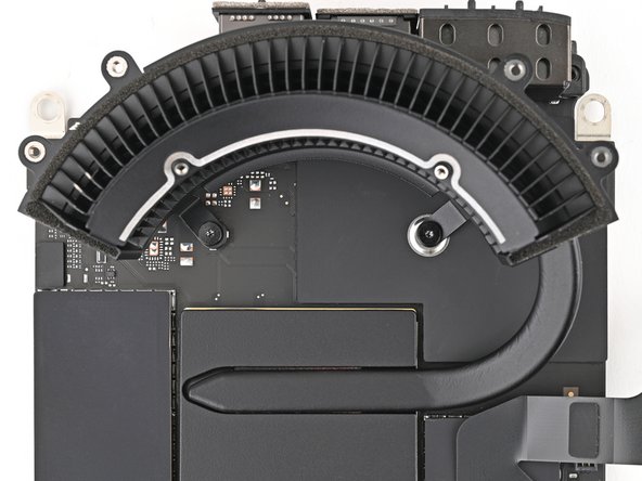

  17. How to Replace the Thermal Paste in your Mac mini (2024), Remove the fan screws: step 17, image 1 of 2 How to Replace the Thermal Paste in your Mac mini (2024), Remove the fan screws: step 17, image 2 of 2
    • If you're following this guide to clean your fan, this is a good time to do so.
    • Remove the four screws securing the fan:
    • Two 2.4 mm‑long Torx Plus 3IP screws
    • Two 7.9 mm‑long Torx Plus 5IP screws

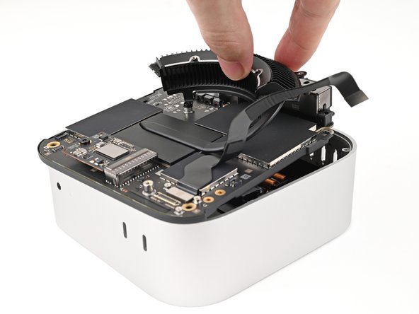

  18. How to Replace the Thermal Paste in your Mac mini (2024), Reposition the fan: step 18, image 1 of 3 How to Replace the Thermal Paste in your Mac mini (2024), Reposition the fan: step 18, image 2 of 3 How to Replace the Thermal Paste in your Mac mini (2024), Reposition the fan: step 18, image 3 of 3
    • Lift the fan out of its recess in the chassis and flip it over to expose its wire and connector.
    • Let the fan rest on the chassis and heat sink.

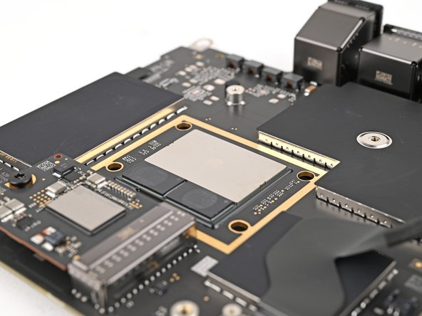

  42. How to Replace the Thermal Paste in your Mac mini (2024), Remove the logic board screws: step 42, image 1 of 2 How to Replace the Thermal Paste in your Mac mini (2024), Remove the logic board screws: step 42, image 2 of 2
    • Remove the six screws securing the logic board:
    • Three 6.8 mm‑long T8 Torx screws
    • One 16.2 mm‑long T8 Torx screw
    • Two 4.2 mm‑long T5 Torx screws
  43. How to Replace the Thermal Paste in your Mac mini (2024), Release the logic board: step 43, image 1 of 2 How to Replace the Thermal Paste in your Mac mini (2024), Release the logic board: step 43, image 2 of 2

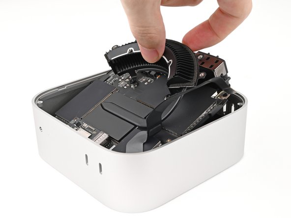

    • Grip the heat sink and pull it away from the edge of the chassis to release the pegs in the rear ports.
  44. How to Replace the Thermal Paste in your Mac mini (2024): step 44, image 1 of 3 How to Replace the Thermal Paste in your Mac mini (2024): step 44, image 2 of 3 How to Replace the Thermal Paste in your Mac mini (2024): step 44, image 3 of 3
    • Don't fully remove the logic board from the chassis yet, as it's still attached by a cable.
    • Lift the rear port side of the logic board out of the chassis before sliding the opposite end out.
    • During reassembly, insert the edge of the logic board opposite the rear ports into the chassis before pressing it down flat.

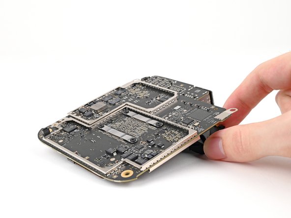

  45. How to Replace the Thermal Paste in your Mac mini (2024): step 45, image 1 of 3 How to Replace the Thermal Paste in your Mac mini (2024): step 45, image 2 of 3 How to Replace the Thermal Paste in your Mac mini (2024): step 45, image 3 of 3
    • Turn the logic board over to expose the power supply cable connector.

    • Use your fingers to grip the power supply cable connector and pull it straight out of its socket to disconnect it.
  47. How to Replace the Thermal Paste in your Mac mini (2024), Remove the logic board: step 47, image 1 of 1
    • Remove the logic board.
  48. How to Replace the Thermal Paste in your Mac mini (2024), Remove the logic board cover: step 48, image 1 of 3 How to Replace the Thermal Paste in your Mac mini (2024), Remove the logic board cover: step 48, image 2 of 3 How to Replace the Thermal Paste in your Mac mini (2024), Remove the logic board cover: step 48, image 3 of 3
    • The rubber cover on the bottom of the logic board is secured with adhesive along its copper pads.
    • Flip over the logic board.
    • While securing the logic board with one hand, use the other to peel off the rubber cover.
    • If pieces of the copper rip and stick to the logic board, don't worry! Keep the copper in place, as it'll fill in the gaps on the rubber cover during reassembly.

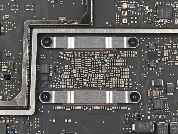

  49. How to Replace the Thermal Paste in your Mac mini (2024), Remove the heat sink bracket screws: step 49, image 1 of 3 How to Replace the Thermal Paste in your Mac mini (2024), Remove the heat sink bracket screws: step 49, image 2 of 3 How to Replace the Thermal Paste in your Mac mini (2024), Remove the heat sink bracket screws: step 49, image 3 of 3
    • Use one hand to secure the logic board during this step to prevent damaging it.
    • Use a Torx Plus 5IP screwdriver to remove the four 4.4 mm‑long screws securing the heat sink bracket.
    • The brackets will bend up as you loosen the screws.
    • During reassembly, tighten the heat sink bracket screws in an "X" pattern.
  50. How to Replace the Thermal Paste in your Mac mini (2024), Remove the brackets: step 50, image 1 of 3 How to Replace the Thermal Paste in your Mac mini (2024), Remove the brackets: step 50, image 2 of 3 How to Replace the Thermal Paste in your Mac mini (2024), Remove the brackets: step 50, image 3 of 3
    • Use tweezers, or your fingers, to remove the heat sink brackets.
  51. How to Replace the Thermal Paste in your Mac mini (2024), Remove the heat sink screws: step 51, image 1 of 2 How to Replace the Thermal Paste in your Mac mini (2024), Remove the heat sink screws: step 51, image 2 of 2
    • Use a Torx Plus 5IP screwdriver to remove the two 4.0 mm‑long screws securing the heat sink.
  52. How to Replace the Thermal Paste in your Mac mini (2024), Remove the heat sink: step 52, image 1 of 2 How to Replace the Thermal Paste in your Mac mini (2024), Remove the heat sink: step 52, image 2 of 2
    • Lift the heat sink off the logic board and remove it.
    • You might feel a little resistance from the thermal paste bonded to the heat sink.
  53. How to Replace the Thermal Paste in your Mac mini (2024), Remove the old thermal paste: step 53, image 1 of 3 How to Replace the Thermal Paste in your Mac mini (2024), Remove the old thermal paste: step 53, image 2 of 3 How to Replace the Thermal Paste in your Mac mini (2024), Remove the old thermal paste: step 53, image 3 of 3
    • Use the flat end of a spudger to scrape off the old thermal paste from the processor.
    • Apply a few drops of isopropyl alcohol (>90%) to the processor and use a coffee filter or a lint-free cloth to wipe away any residue.
    • Repeat this step for the thermal paste on the heat sink.

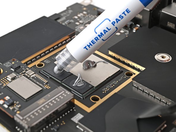

  54. How to Replace the Thermal Paste in your Mac mini (2024), Apply the new thermal paste: step 54, image 1 of 3 How to Replace the Thermal Paste in your Mac mini (2024), Apply the new thermal paste: step 54, image 2 of 3 How to Replace the Thermal Paste in your Mac mini (2024), Apply the new thermal paste: step 54, image 3 of 3
    • Apply a small bead of thermal paste to the each of the three locations on the processor.
    • Follow this guide in reverse order starting with this step to reattach the heat sink. Placing the heat sink back on the processor will evenly spread the thermal paste and bond both parts together.
To reassemble your device, follow these instructions in reverse order, starting with this step.
