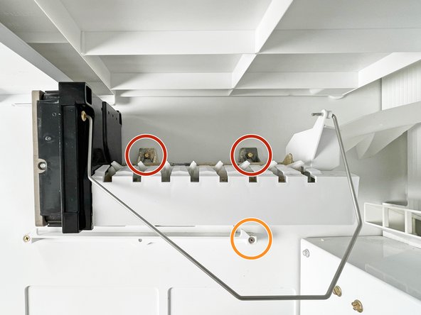

  8. How to Replace the Ice Maker in an Older Whirlpool Refrigerator, Unfastening the ice maker: step 8, image 1 of 1
    • Use a 1/4­‑inch nut driver to loosen the two upper mounting screws.
    • Use a 1/4‑inch nut driver to remove the lower mounting screw.

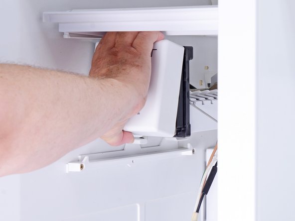

  9. How to Replace the Ice Maker in an Older Whirlpool Refrigerator, Releasing the ice maker: step 9, image 1 of 3 How to Replace the Ice Maker in an Older Whirlpool Refrigerator, Releasing the ice maker: step 9, image 2 of 3 How to Replace the Ice Maker in an Older Whirlpool Refrigerator, Releasing the ice maker: step 9, image 3 of 3
    • Lift the ice maker up to release it from the upper mounting screws.
    • Move it gently away from the wall into the freezer.
    • Don't try to remove the ice maker fully yet because it is still attached by the wiring.

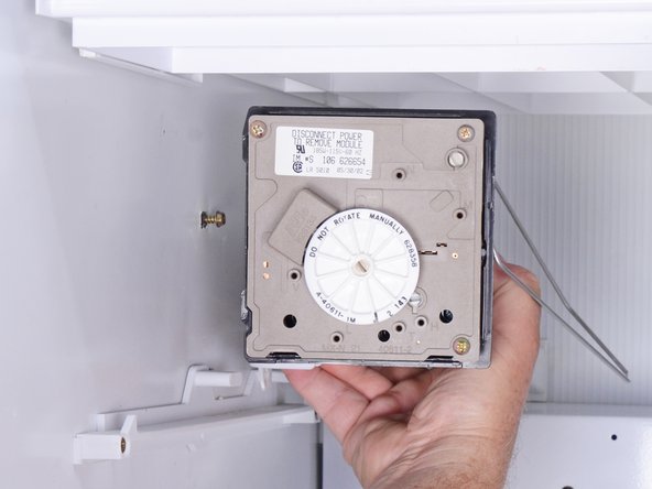

  10. How to Replace the Ice Maker in an Older Whirlpool Refrigerator, Disconnect the ice maker wiring: step 10, image 1 of 3 How to Replace the Ice Maker in an Older Whirlpool Refrigerator, Disconnect the ice maker wiring: step 10, image 2 of 3 How to Replace the Ice Maker in an Older Whirlpool Refrigerator, Disconnect the ice maker wiring: step 10, image 3 of 3
    • Lower the ice maker partially to access the cable lock tab on the upper front of the ice maker.
    • Use a spudger or flat head screwdriver to press in the cable lock tab to release the cable.

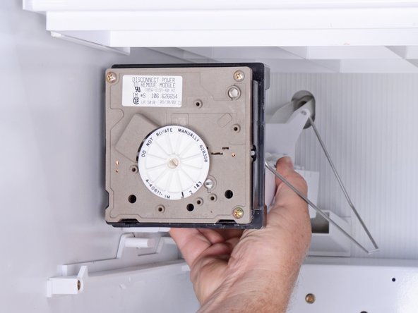

  11. How to Replace the Ice Maker in an Older Whirlpool Refrigerator: step 11, image 1 of 2 How to Replace the Ice Maker in an Older Whirlpool Refrigerator: step 11, image 2 of 2
    • Pull the cable out of the socket to disconnect it.

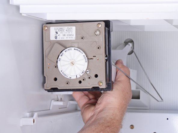

  12. How to Replace the Ice Maker in an Older Whirlpool Refrigerator, Detach the thermal fuse: step 12, image 1 of 3 How to Replace the Ice Maker in an Older Whirlpool Refrigerator, Detach the thermal fuse: step 12, image 2 of 3 How to Replace the Ice Maker in an Older Whirlpool Refrigerator, Detach the thermal fuse: step 12, image 3 of 3
    • Slide the ice maker off of the thermal fuse.
    • Sliding the thermal fuse off will likely be easier than unclipping it.
    • During reassembly, remember to clip the thermal fuse onto the ice maker.
