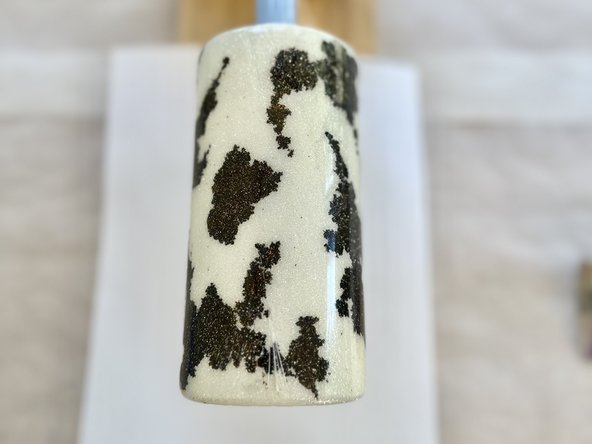

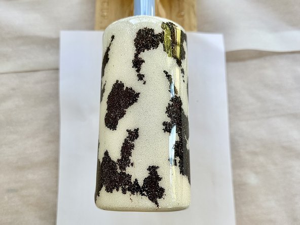

  1. How to Repair Chipped, Cracked, or Flaking Epoxy Resin Projects, How to Repair Chipped, Cracked, or Flaking Epoxy Resin Projects: step 1, image 1 of 2 How to Repair Chipped, Cracked, or Flaking Epoxy Resin Projects, How to Repair Chipped, Cracked, or Flaking Epoxy Resin Projects: step 1, image 2 of 2
    • Place your project on the tumbler turner to evaluate why your project sustained damage.
    • For this project, a motorized turner was used while working with wet epoxy. A tumbler turner is recommended for any rounded projects to ensure even coating and curing.
    • Non-round projects can be secured using their original mold or by purchasing a mold that fits the project. If a pre-made mold isn’t available, you can easily create one using liquid silicone rubber and a disposable container, such as a takeout box or Tupperware. Liquid silicone rubber is readily available online or at most craft stores.

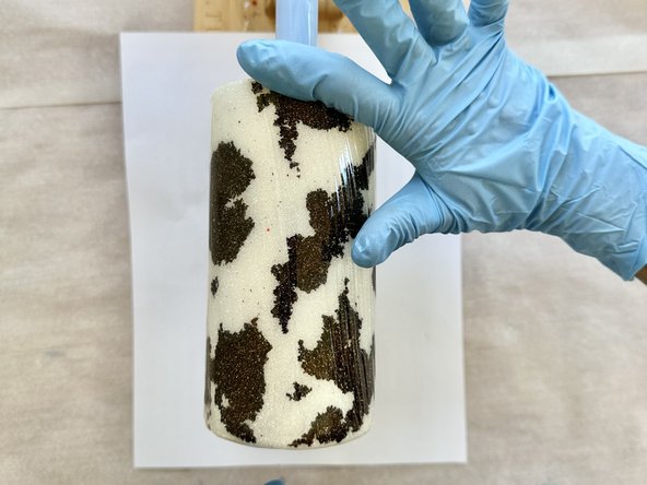

  2. How to Repair Chipped, Cracked, or Flaking Epoxy Resin Projects: step 2, image 1 of 2 How to Repair Chipped, Cracked, or Flaking Epoxy Resin Projects: step 2, image 2 of 2

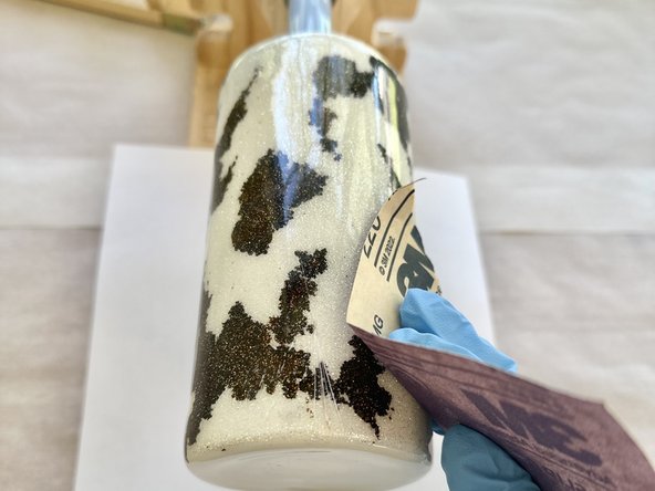

    • Lightly sand your project with 220-grit sandpaper.
    • A 220-grit sandpaper is fine enough to be gentle yet effective. Lower grit sandpaper is more abrasive and can scratch the surface layer of the epoxy. Higher grits than 220 are also suitable but may require more physical effort to achieve the desired finish.
    • Sand away any rough edges, but take care to avoid peeling off any epoxy that might be flaking or chipping.
    • If your project has flaking epoxy, lightly buff away any flakes that might break off to prevent contamination of new layers of epoxy.

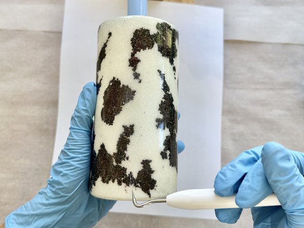

    • Using a sharp instrument such as a toothpick, precision knife, or weeding tool (as shown), gently extract any dust or debris that has settled into holes or cracks in the existing layers during sanding.

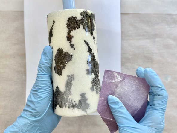

    • Use 93% isopropyl alcohol to clean the sanded project.
    • Wipe away any alcohol and remaining sanding dust with a microfiber cloth.
    • A coffee filter or non-fibrous cloth will suffice if you do not have a microfiber cloth on hand.

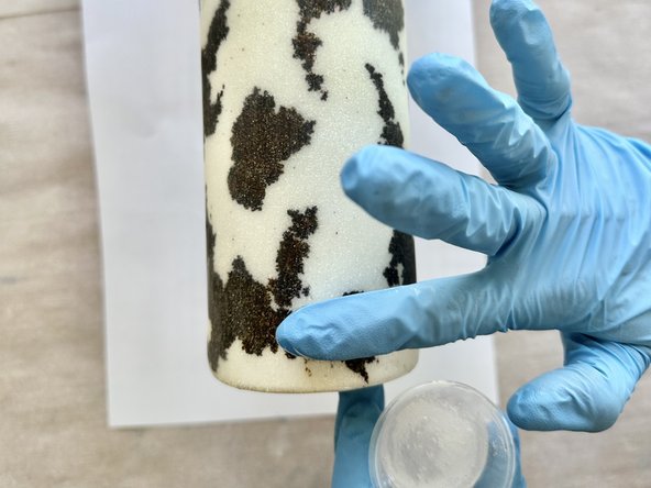

    • In a well-ventilated area, mix together your epoxy resin according to the manufacturer's directions using a medicine cup and stir stick.
    • Gloves, a respiratory mask, and any other recommended safety equipment should be worn when handling wet epoxy resin. Check the label of your epoxy resin for the manufacturer's recommendations.
    • Stir slowly in a clockwise motion, being sure to scrape the sides and bottom. Your epoxy resin is ready to use once it is completely clear.
    • It is okay if your epoxy resin has bubbles, but it should not have streaks or other indicators of undermixing.
  7. How to Repair Chipped, Cracked, or Flaking Epoxy Resin Projects: step 7, image 1 of 3 How to Repair Chipped, Cracked, or Flaking Epoxy Resin Projects: step 7, image 2 of 3 How to Repair Chipped, Cracked, or Flaking Epoxy Resin Projects: step 7, image 3 of 3
    • Focusing on the damaged part of the project, rub some of the epoxy resin into the treated area. Allow the epoxy resin to seep into any remaining cracks or holes.
    • If your project has holes or fisheyes, concentrate on filling these areas in to apply an even layer.
    • You should notice the treated area's imperfections disappear after this step if all prior steps have been performed correctly and thoroughly.
