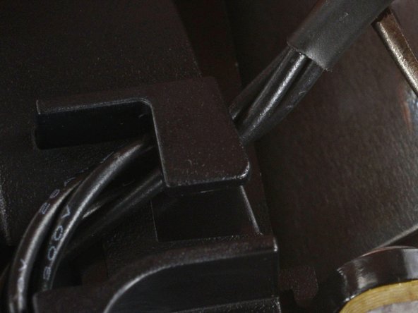

    • During reassembly, route the fan cable underneath its small cable guide on the fan housing so it doesn't interfere with the back panel.

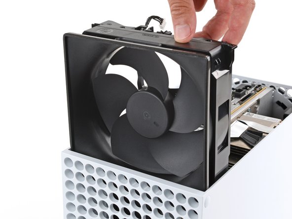

  12. How to Open and Clean an Xbox Series X (Digital Edition), Remove the fan: step 12, image 1 of 3 How to Open and Clean an Xbox Series X (Digital Edition), Remove the fan: step 12, image 2 of 3 How to Open and Clean an Xbox Series X (Digital Edition), Remove the fan: step 12, image 3 of 3
    • Slide the fan out of its slot to remove it.
    • During reassembly, note that the fan can only be installed one way—make sure Master Chief is facing you.

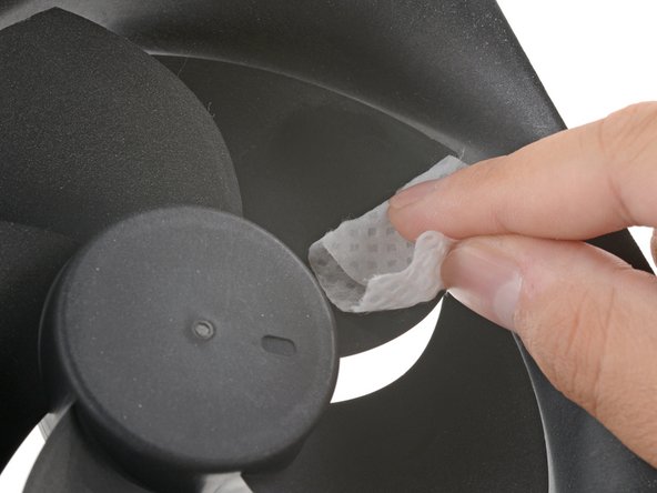

    • Over time, dust will build up inside the fan and on the fan blades.
    • Use a pair of tweezers to grab loose hairs and dust clumps off of the fan.
    • Use a small dust blower or light compressed air to blow remaining dust off of the fan.
    • Use a finger to keep the fan blades steady—it makes them easier to clean.
    • If there's a layer of grime on the fan blades, use soapy water on a damp rag or an isopropyl alcohol wipe to clean it off.

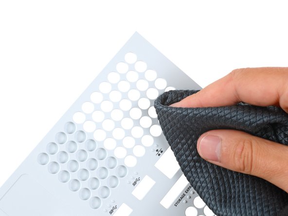

    • Use a clean rag or microfiber cloth to wipe both sides of the back panel clean.
