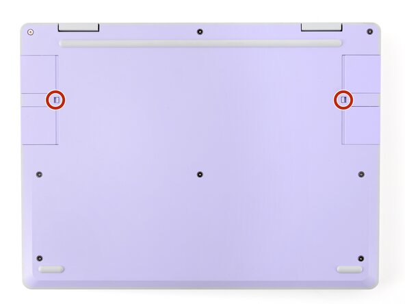

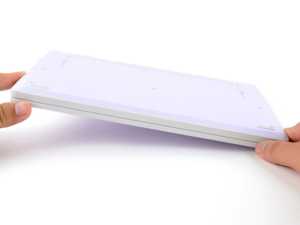

    • Set your Framework Laptop face-down on a clean work surface.
  2. How to Lock the Expansion Cards in Your Framework Laptop 12, Lock the Expansion Cards: step 2, image 1 of 3 How to Lock the Expansion Cards in Your Framework Laptop 12, Lock the Expansion Cards: step 2, image 2 of 3 How to Lock the Expansion Cards in Your Framework Laptop 12, Lock the Expansion Cards: step 2, image 3 of 3

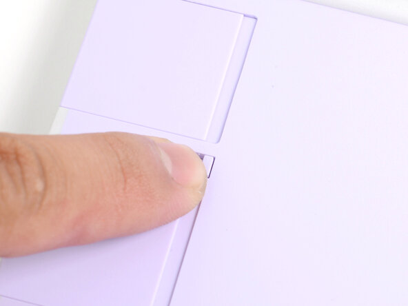

    • Use your fingers to flip both Expansion Card latches to the lock position. The red bar shouldn't show on the latches.

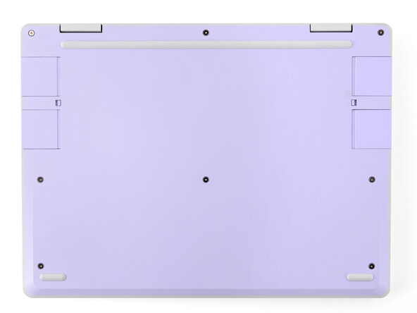

  3. How to Lock the Expansion Cards in Your Framework Laptop 12, Loosen the bottom screws: step 3, image 1 of 2 How to Lock the Expansion Cards in Your Framework Laptop 12, Loosen the bottom screws: step 3, image 2 of 2
    • Use your Framework Screwdriver to fully loosen the eight captive T5 Torx screws on the bottom of your laptop.
    • Most screws in your Framework Laptop (including these) are captive—they're designed to stay in place after you loosen them.
    • Your laptop comes with a spare set of screws in the frame above the battery. Be careful—the replacement screws aren't captive.

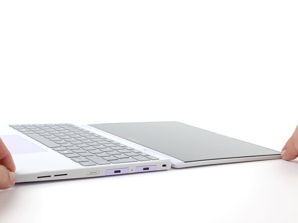

  5. How to Lock the Expansion Cards in Your Framework Laptop 12, Open your laptop: step 5, image 1 of 2 How to Lock the Expansion Cards in Your Framework Laptop 12, Open your laptop: step 5, image 2 of 2
    • Open the laptop lid so that both the screen and the base lie flat on your work surface.
