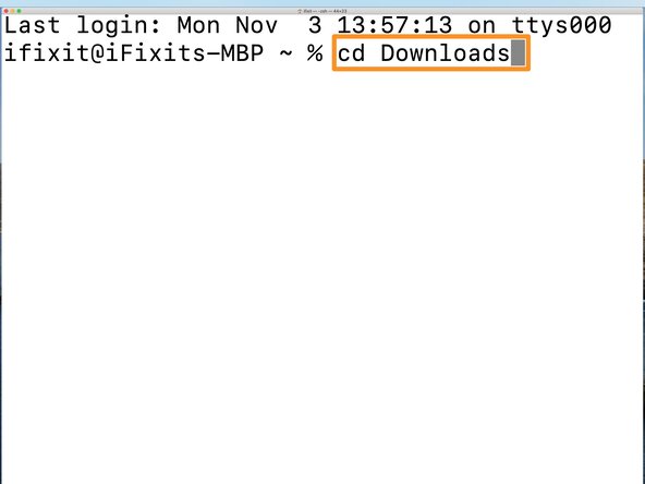

    2. How to Install Linux on a T2 Mac, Download and Verify CachyOS: step 2, image 1 of 3 How to Install Linux on a T2 Mac, Download and Verify CachyOS: step 2, image 2 of 3 How to Install Linux on a T2 Mac, Download and Verify CachyOS: step 2, image 3 of 3
      • To ensure the file downloads correctly, CachyOS provides a checksum for each disk image (.iso) file. This is how it's verified.
      • Download CachyOS Desktop Edition and its checksum. We recommend using the Direct download.
      • Open the MacOS Terminal app.
      • Type cd Downloads and press Enter. If prompted, allow Terminal to access the Downloads folder.
      • Type shasum ‑a 256 ‑c cachyos‑desktop‑linux‑[version].iso.sha256, where [version] is the number in the name of the file you downloaded.
      • Ensure it says OK. If it doesn't, re-download the file or download from a different mirror (like Sourceforge).

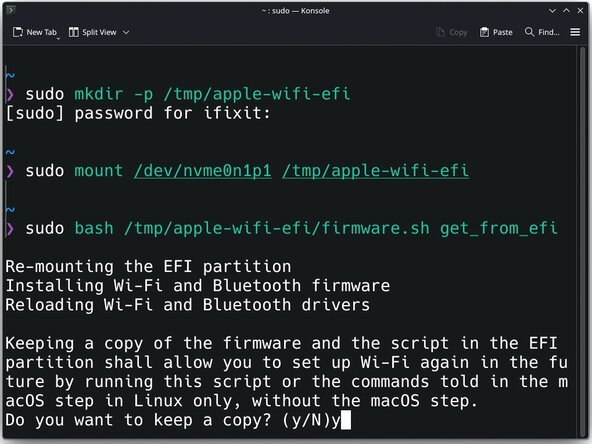

    15. How to Install Linux on a T2 Mac, Install Wi-Fi drivers: step 15, image 1 of 2 How to Install Linux on a T2 Mac, Install Wi-Fi drivers: step 15, image 2 of 2
      • If the Wi‑Fi works automatically, skip this step.
      • Open the Terminal and type the following commands, pressing Enter after each one:
      • sudo mkdir ‑p /tmp/apple‑wifi‑efi
      • sudo mount /dev/nvme0n1p1 /tmp/apple‑wifi‑efi
      • If your drive is in a different location, use its path instead. Type lsblk to list the drives and their partitions. Use the one with /boot/efi next to it.
      • sudo bash /tmp/apple‑wifi‑efi/firmware.sh get_from_efi
      • When prompted, type y to keep a copy of the firmware in case you need it later.
      • sudo umount /tmp/apple‑wifi‑efi
      Ask FixBot
