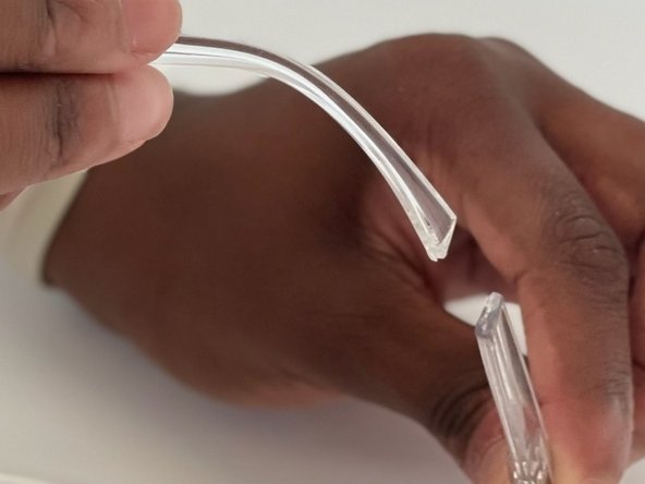

How to Fix a Broken Temple Arm of Gaoye Blue Light Eyeglasses
  1. How to Fix a Broken Temple Arm of Gaoye Blue Light Eyeglasses, How to Fix a Broken Temple Arm of Gaoye Blue Light Eyeglasses: step 1, image 1 of 3 How to Fix a Broken Temple Arm of Gaoye Blue Light Eyeglasses, How to Fix a Broken Temple Arm of Gaoye Blue Light Eyeglasses: step 1, image 2 of 3 How to Fix a Broken Temple Arm of Gaoye Blue Light Eyeglasses, How to Fix a Broken Temple Arm of Gaoye Blue Light Eyeglasses: step 1, image 3 of 3

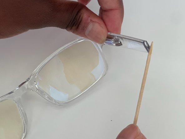

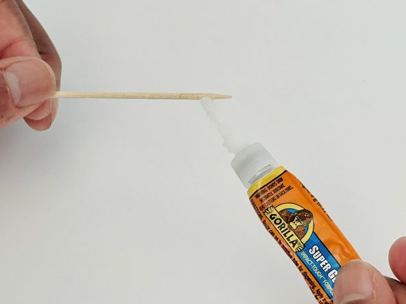

  4. How to Fix a Broken Temple Arm of Gaoye Blue Light Eyeglasses: step 4, image 1 of 3 How to Fix a Broken Temple Arm of Gaoye Blue Light Eyeglasses: step 4, image 2 of 3 How to Fix a Broken Temple Arm of Gaoye Blue Light Eyeglasses: step 4, image 3 of 3

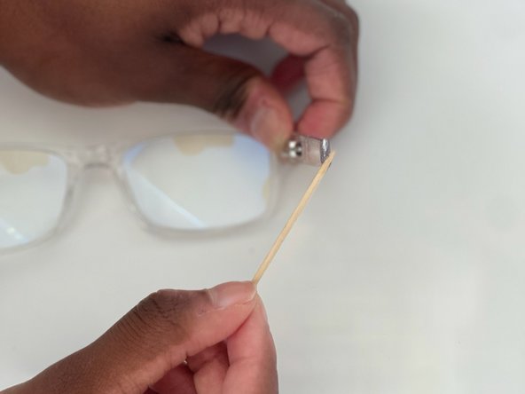

    • Use the coated toothpick to apply a thin layer of Gorilla Super Glue to one of the broken temple arm sections.
    • Gorilla Super Glue works better when less of the product is applied. Make sure to only apply a thin layer of glue to the broken temple arm section.

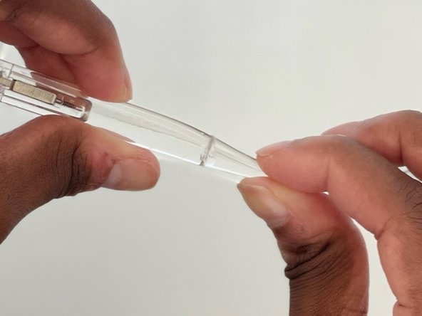

    • Press the two temple arm sections together and hold for one minute.
    • Caution: Gorilla Super Glue can remain on your skin for up to a week. Place hands away from the glue applied when holding the temple sections together to keep hands clean.

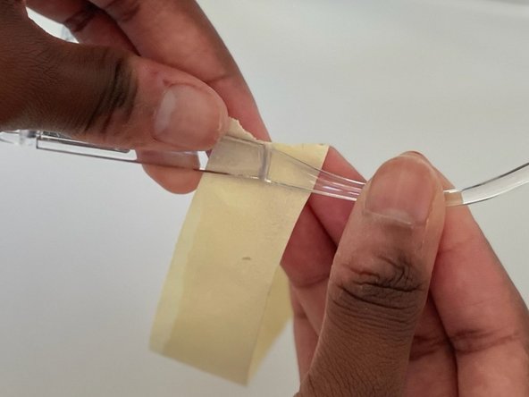

  6. How to Fix a Broken Temple Arm of Gaoye Blue Light Eyeglasses: step 6, image 1 of 3 How to Fix a Broken Temple Arm of Gaoye Blue Light Eyeglasses: step 6, image 2 of 3 How to Fix a Broken Temple Arm of Gaoye Blue Light Eyeglasses: step 6, image 3 of 3
    • Tightly wrap masking tape around the area where you placed the temple arm sections together.
    • Leave the masking tape on for five minutes.

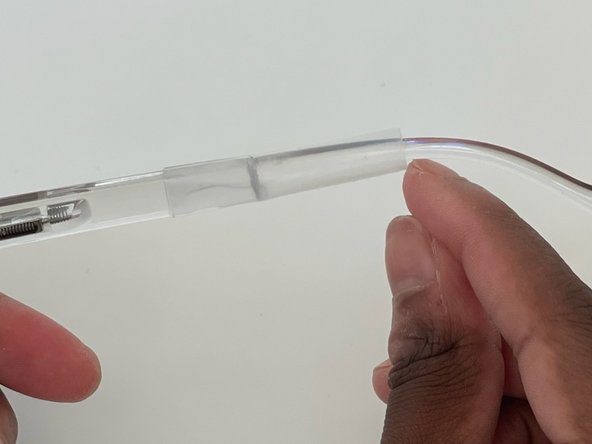

  8. How to Fix a Broken Temple Arm of Gaoye Blue Light Eyeglasses: step 8, image 1 of 3 How to Fix a Broken Temple Arm of Gaoye Blue Light Eyeglasses: step 8, image 2 of 3 How to Fix a Broken Temple Arm of Gaoye Blue Light Eyeglasses: step 8, image 3 of 3

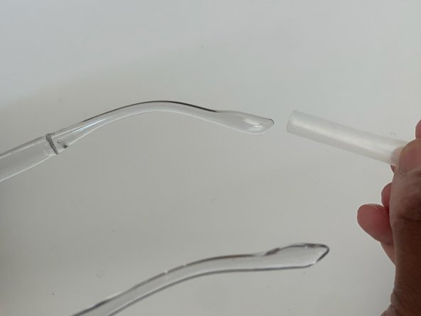

    • Select a 1/4" heat-shrinking tube.
    • Slide the tube to the area where you applied the Gorilla Super Glue.

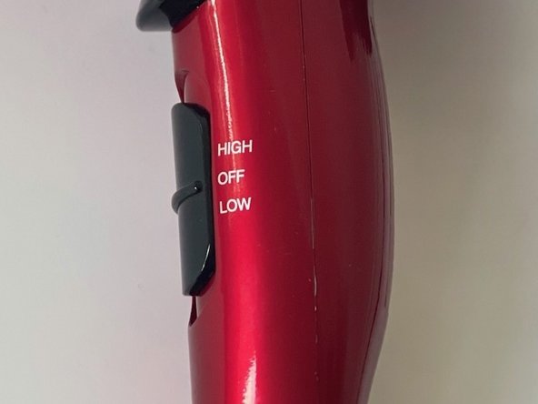

    • Plug in a handheld hair dryer.
    • Turn the handheld hair dryer to the highest heat setting.

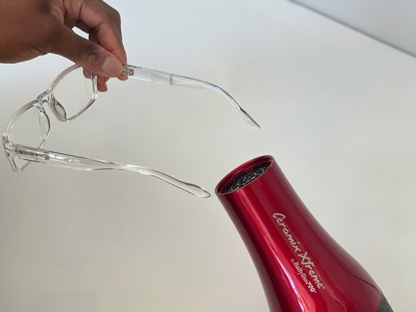

    • Circulate the handheld hair dryer around the heat-shrinking tube until it is suctioned around the temple arm.
    • Caution: Keep your fingers away from the area you are aiming the hair dryer. The hair dryer produces high levels of heat that can irritate or burn a person's skin.
