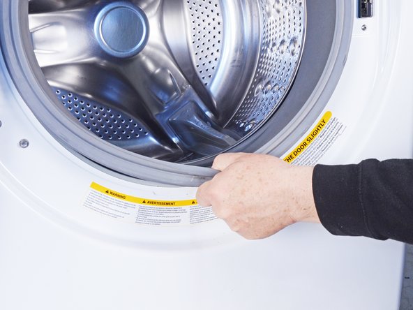

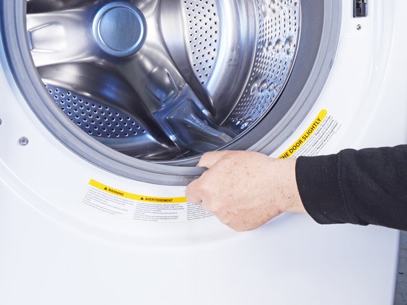

  1. How to Clean the Rubber Boot in Your LG WM3050CW Washing Machine, Open the door: step 1, image 1 of 2 How to Clean the Rubber Boot in Your LG WM3050CW Washing Machine, Open the door: step 1, image 2 of 2
    • Open the front door completely.
