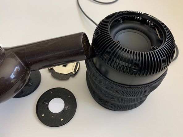

    1. HomePod Disassembly, Top Touch Cover: step 1, image 1 of 2 HomePod Disassembly, Top Touch Cover: step 1, image 2 of 2
      • Be sure to unplug your HomePod before disassembly.
      • Using a hairdryer on hot, heat up the top touch surface and remove.
      • The cover is not flexible. Special care must be taken to avoid cracking or snapping the top cover.

    2. HomePod Disassembly, Removing the Touch Surface: step 2, image 1 of 3 HomePod Disassembly, Removing the Touch Surface: step 2, image 2 of 3 HomePod Disassembly, Removing the Touch Surface: step 2, image 3 of 3
      • Remove four T6 screws.
      • Using a hair dryer on hot, soften the adhesive holding the touch pad assembly to the top frame.
      • Using a guitar pick, carefully pry up the touch pad.
      Ask FixBot

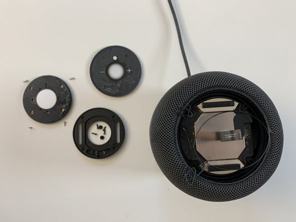

    5. HomePod Disassembly, Touch Surface Support Plate: step 5, image 1 of 2 HomePod Disassembly, Touch Surface Support Plate: step 5, image 2 of 2
      • Remove the four T6 screws securing the touch surface support disc to the lid and slide the 3D mesh fabric sleeve downwards.
      • Remove the touch surface support frame disk from the HomePod.
      Ask FixBot

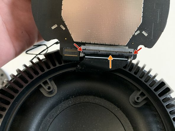

    6. HomePod Disassembly, Logic Board Removal: step 6, image 1 of 3 HomePod Disassembly, Logic Board Removal: step 6, image 2 of 3 HomePod Disassembly, Logic Board Removal: step 6, image 3 of 3
      • Flip the logic board up and using a spudger, carefully pry the retaining lever upwards.
      • Pop the ribbon cable straight upwards and out. This cable has "ears" on each side and doesn't not slide into the connector.
      Ask FixBot

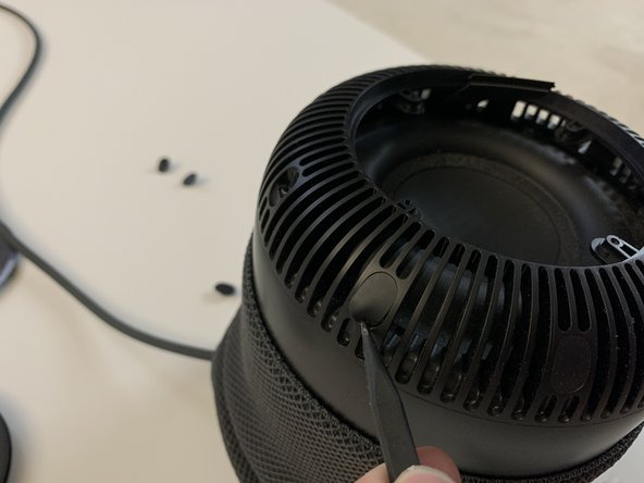

    7. HomePod Disassembly, Top Cover Removal (screws): step 7, image 1 of 3 HomePod Disassembly, Top Cover Removal (screws): step 7, image 2 of 3 HomePod Disassembly, Top Cover Removal (screws): step 7, image 3 of 3
      • Using a spudger, remove the nine rubber screw caps.
      • Using a Torx T6 screwdriver, remove the nine T6 screws securing the top to the main housing.
      Ask FixBot

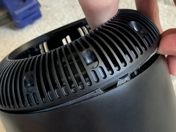

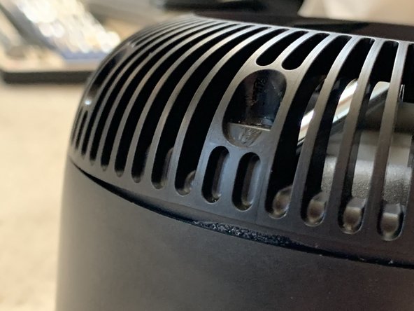

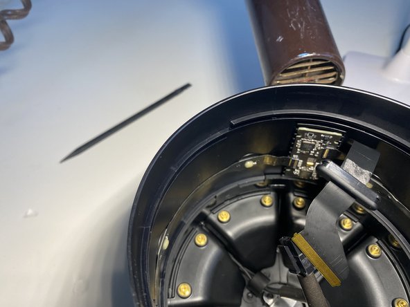

    8. HomePod Disassembly, Softening the Adhesive: step 8, image 1 of 3 HomePod Disassembly, Softening the Adhesive: step 8, image 2 of 3 HomePod Disassembly, Softening the Adhesive: step 8, image 3 of 3
      • Using a hairdryer on high heat, aim the hairdryer as shown and heat the perimeter just below the seam where the top meets the main housing.
      • This step is critical. If you have trouble with the next step, repeat the heating process in the trouble area.
      Ask FixBot

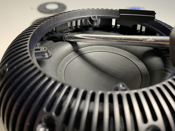

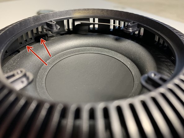

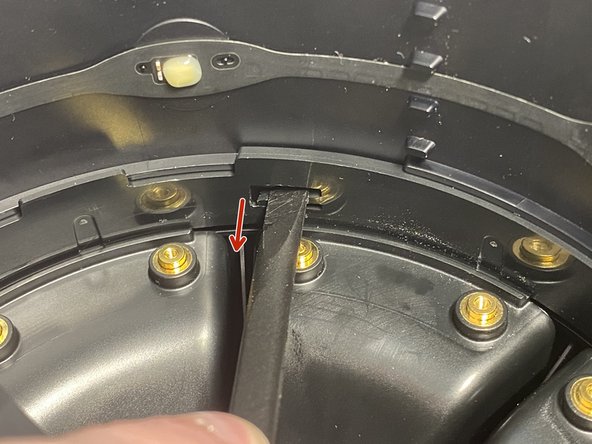

    9. HomePod Disassembly, Separating the Top: step 9, image 1 of 3 HomePod Disassembly, Separating the Top: step 9, image 2 of 3 HomePod Disassembly, Separating the Top: step 9, image 3 of 3
      • This step requires significant force even with plenty of heat applied in the previous step.
      • Insert a wide flat blade screwdriver wrapped in 1-2 layers of electrical tape.
      • You will need to apply a fair amount of pressure to wedge the screwdriver head in the small gap.
      • Pull the top cover straight up. This will need to be done in four sections.
      Ask FixBot
    10. HomePod Disassembly, Top Removal (continued): step 10, image 1 of 3 HomePod Disassembly, Top Removal (continued): step 10, image 2 of 3 HomePod Disassembly, Top Removal (continued): step 10, image 3 of 3
      • Be careful when freeing the top from the glue. The ribbon cable we disconnected in Step 7 is adhered to the top and can easily become torn.
      Ask FixBot
    11. HomePod Disassembly, Top Removal (continued 2): step 11, image 1 of 2 HomePod Disassembly, Top Removal (continued 2): step 11, image 2 of 2
      • Careful peel the ribbon cable from the top.
      • Take your time as you don't want to tear this cable.
      Ask FixBot

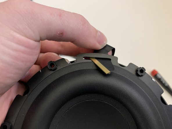

    12. HomePod Disassembly, Woofer Removal: step 12, image 1 of 3 HomePod Disassembly, Woofer Removal: step 12, image 2 of 3 HomePod Disassembly, Woofer Removal: step 12, image 3 of 3
      • Remove the six Torx T6 screws securing the woofer.
      • Carefully lift the woofer out by it's edges and slip the logic board ribbon cable through.
      Ask FixBot
    13. HomePod Disassembly, Disconnecting the Woofer: step 13, image 1 of 3 HomePod Disassembly, Disconnecting the Woofer: step 13, image 2 of 3 HomePod Disassembly, Disconnecting the Woofer: step 13, image 3 of 3
      • Support the woofer on the top edge of the HomePod with your hand.
      • With your other hand, reach inside and squeeze the tab on the connector and pull strait up to disconnect the woofer from the amplifier board.
      • Remove the woofer from the HomePod.
      Ask FixBot

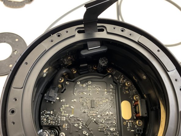

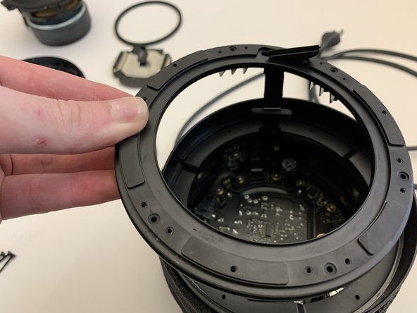

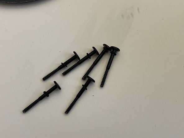

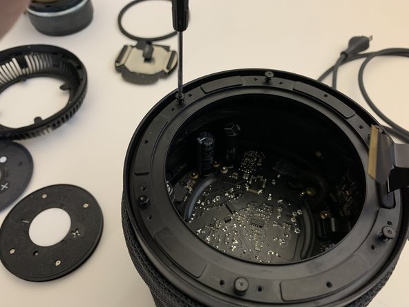

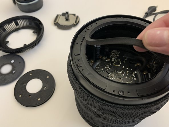

    15. HomePod Disassembly, Upper Ring Removal: step 15, image 1 of 3 HomePod Disassembly, Upper Ring Removal: step 15, image 2 of 3 HomePod Disassembly, Upper Ring Removal: step 15, image 3 of 3
      • Remove the six Torx T6 screws.
      • Note the small delicate rubber O rings that go with each screw. Replace any damaged or missing O rings.
      Ask FixBot
    16. HomePod Disassembly, Upper Ring Removal (Continued): step 16, image 1 of 3 HomePod Disassembly, Upper Ring Removal (Continued): step 16, image 2 of 3 HomePod Disassembly, Upper Ring Removal (Continued): step 16, image 3 of 3
      • Using a spudger, push the silicone grommet through the upper ring.
      • Remove the upper ring from the HomePod.
      Ask FixBot

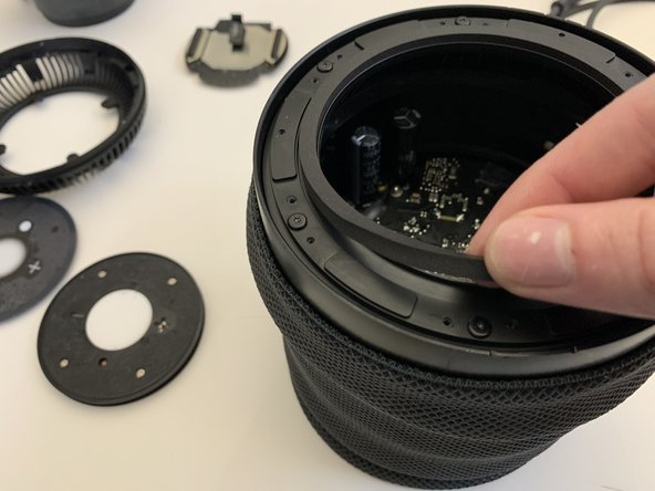

    17. HomePod Disassembly, Middle Ring Removal: step 17, image 1 of 3 HomePod Disassembly, Middle Ring Removal: step 17, image 2 of 3 HomePod Disassembly, Middle Ring Removal: step 17, image 3 of 3
      • With the upper ring removed, remove the grommet from the ribbon cable.
      • Rotate the middle ring counter clockwise to unscrew it from the HomePod.
      Ask FixBot

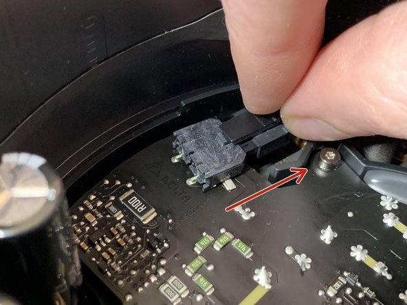

    18. HomePod Disassembly, Power Supply Removal: step 18, image 1 of 3 HomePod Disassembly, Power Supply Removal: step 18, image 2 of 3 HomePod Disassembly, Power Supply Removal: step 18, image 3 of 3
      • Push down on the locking tab and pull in the direction of the arrow.
      • Remove the four Torx T6 screws securing the power supply to the amplifier board.
      Ask FixBot
    19. HomePod Disassembly, Power Supply Removal Tips: step 19, image 1 of 3 HomePod Disassembly, Power Supply Removal Tips: step 19, image 2 of 3 HomePod Disassembly, Power Supply Removal Tips: step 19, image 3 of 3
      • Be sure to pull straight up (orange arrow) when removing the power supply (after removing the screws). This connector is fragile and easily damaged during removal and installation!
      • The third photo shows how the power supply board properly mates with the amplifier board.
      Ask FixBot

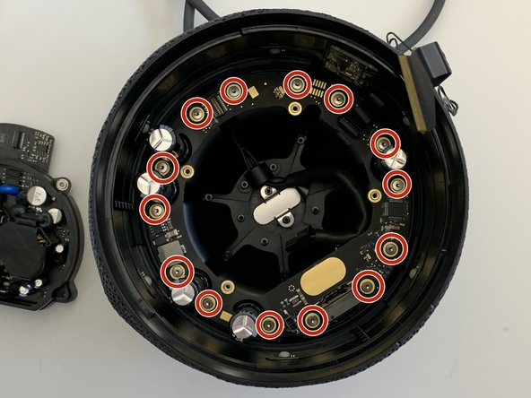

    20. HomePod Disassembly, Amplifier Board Removal: step 20, image 1 of 3 HomePod Disassembly, Amplifier Board Removal: step 20, image 2 of 3 HomePod Disassembly, Amplifier Board Removal: step 20, image 3 of 3
      • Disconnect the ribbon cable connecting the amplifier board to the logic board.
      • Remove the 14 Torx T6 screws securing the amplifier board to the 7 tweeters.
      • Carefully lift out and remove the amplifier board from the HomePod.
      Ask FixBot

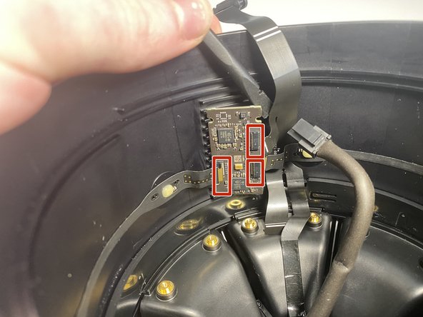

    21. HomePod Disassembly, Microphone Board Removal: step 21, image 1 of 3 HomePod Disassembly, Microphone Board Removal: step 21, image 2 of 3 HomePod Disassembly, Microphone Board Removal: step 21, image 3 of 3
      • Disconnect the 3 ribbon cables from the Microphone board.
      • Using a hair dryer, heat the microphone board from the back side.
      • Using a plastic spudger, remove the PCB from the housing.
      Ask FixBot

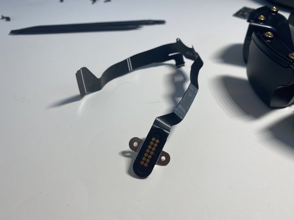

    24. HomePod Disassembly, Main Ribbon Cable Removal: step 24, image 1 of 3 HomePod Disassembly, Main Ribbon Cable Removal: step 24, image 2 of 3 HomePod Disassembly, Main Ribbon Cable Removal: step 24, image 3 of 3
      • Remove the two T6 screws securing the diagnostic port to the bottom housing
      • Careful peel the ribbon cable from the wall of the HomePod. Take care not to tear this cable.
      • Remember it helps to heat the outside of the housing near the ribbon cable with a hair dryer to soften the adhesive securing this ribbon cable in place.
      Ask FixBot
