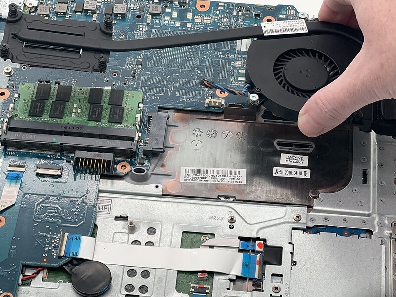

    1. HP ProBook 640 G2 Fan Replacement, Fan: step 10, image 1 of 3 HP ProBook 640 G2 Fan Replacement, Fan: step 10, image 2 of 3 HP ProBook 640 G2 Fan Replacement, Fan: step 10, image 3 of 3
      • Use the point of a spudger to push on alternating sides of the fan connector to "walk" it out of its socket.
      • It may take a lot of alternating before the connector comes out. Be patient, and don't pull on the cables.
      • If that doesn't work, use a pair of tweezers to firmly grip the sides of the connector and pull straight away from the socket. Hold the tweezers closer to the connector to get a better grip.
      • Use a JIS J1 screwdriver to loosen the six captive screws securing the fan and heat sink assembly.
      Ask FixBot
    2. HP ProBook 640 G2 Fan Replacement: step 11, image 1 of 1
      • Carefully lift out the fan and heatsink assembly.
      • Use compressed air to clean dust, or replace with a compatible fan if faulty.
