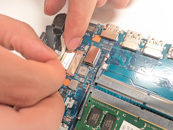

    1. HP 250 G7 Display Replacement, Display: step 6, image 1 of 3 HP 250 G7 Display Replacement, Display: step 6, image 2 of 3 HP 250 G7 Display Replacement, Display: step 6, image 3 of 3
      • Pull back the tape holding the display connector.
      • Disconnect the display connector from the board.
      • Make sure to be gentle when removing as damaging the port will result in the screen no longer working.
      • Remove the cable from the clip so that it is out of the way.

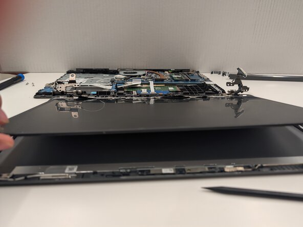

    3. HP 250 G7 Display Replacement: step 8, image 1 of 3 HP 250 G7 Display Replacement: step 8, image 2 of 3 HP 250 G7 Display Replacement: step 8, image 3 of 3
      • Rotate the hinges upwards to a perpendicular position.
      • Remove the white wire from the clips but do not remove from the board. Please be mindful of this wire when conducting further steps.

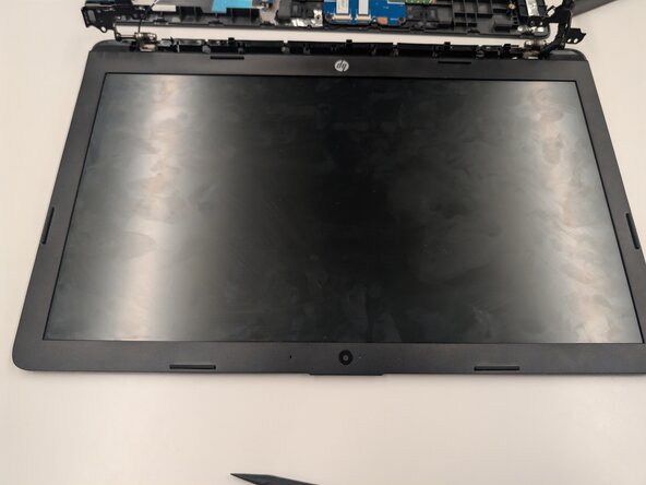

    5. HP 250 G7 Display Replacement: step 10, image 1 of 3 HP 250 G7 Display Replacement: step 10, image 2 of 3 HP 250 G7 Display Replacement: step 10, image 3 of 3
      • Remove the display bezel by flexing the top, then the sides, then the bottom until the bezel disengages from the display assembly.
      • Use the spudger to remove it from the frame if necessary.
