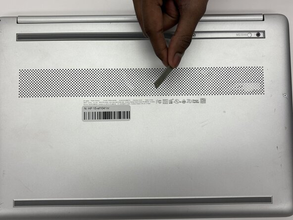

    1. HP 15-ef1041nr RAM Replacement, Lower Case: step 1, image 1 of 3 HP 15-ef1041nr RAM Replacement, Lower Case: step 1, image 2 of 3 HP 15-ef1041nr RAM Replacement, Lower Case: step 1, image 3 of 3
      • Use an opening tool to remove the two rubber feet on the lower case.
      • If you intend to reuse the feet, first use a hair dryer to heat the feet and take care not to tear or warp the feet during removal.
      • Place the rubber strips off to the side with the stickey side up.
