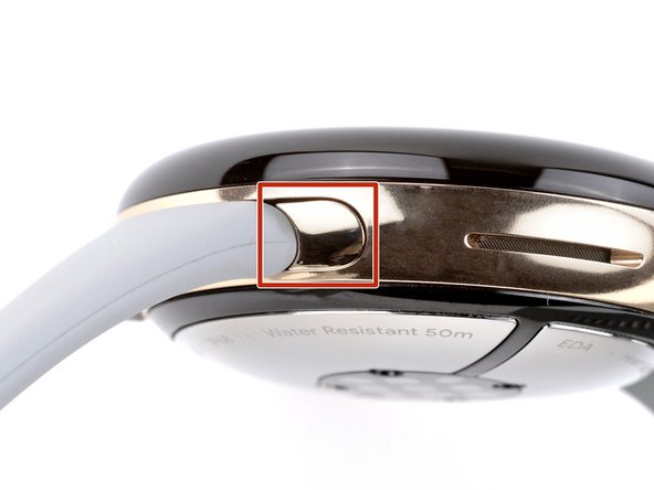

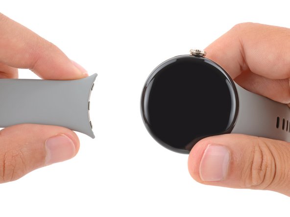

  2. Google Pixel Watch 2 Vibration Motor Replacement, Remove both watch bands: step 2, image 1 of 2 Google Pixel Watch 2 Vibration Motor Replacement, Remove both watch bands: step 2, image 2 of 2
    • Remove both watch bands by pressing the release button and sliding the band out of its groove.

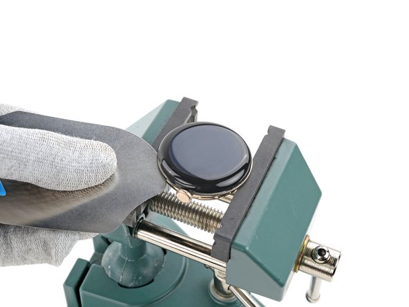

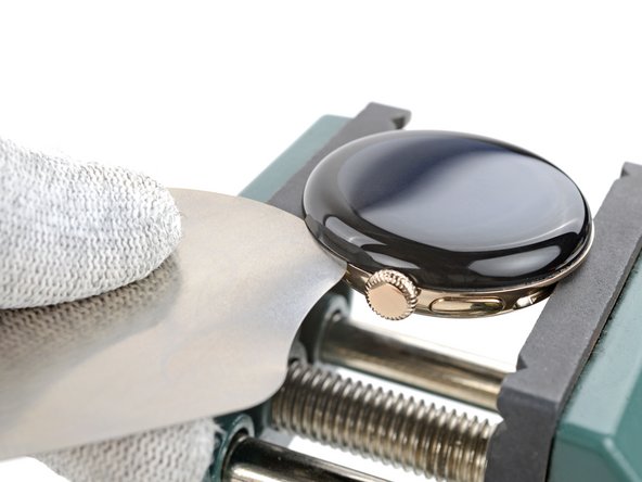

  3. Google Pixel Watch 2 Vibration Motor Replacement, Put your watch in the vise: step 3, image 1 of 1
    • Inserting a tool between the screen and frame is very difficult. Using a vise to secure the frame makes it significantly easier.
    • Secure your watch with a small vise so the jaws go into the watch band grooves on the frame.
    • If your vice has sharp or metal jaws, consider wrapping the frame in a thin cloth to prevent scratching or damaging the frame.

  6. Google Pixel Watch 2 Vibration Motor Replacement, Insert an iFlex: step 6, image 1 of 3 Google Pixel Watch 2 Vibration Motor Replacement, Insert an iFlex: step 6, image 2 of 3 Google Pixel Watch 2 Vibration Motor Replacement, Insert an iFlex: step 6, image 3 of 3
    • Insert the tip of an iFlex between the screen and frame just below the watch crown (opposite the side button).
    • This is very difficult and will take multiple attempts. If the screen cools down, apply more heat and try again.
    • Rotate the iFlex so its longer edge is between the screen and frame.

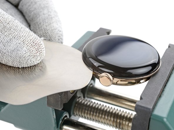

  7. Google Pixel Watch 2 Vibration Motor Replacement, Separate the screen adhesive: step 7, image 1 of 3 Google Pixel Watch 2 Vibration Motor Replacement, Separate the screen adhesive: step 7, image 2 of 3 Google Pixel Watch 2 Vibration Motor Replacement, Separate the screen adhesive: step 7, image 3 of 3
    • Hold the iFlex at a slight upward angle and slide it clockwise around the perimeter of the watch to separate the adhesive. Stop when you reach the side button.
    • Don't slide farther than this or you'll damage the screen cable.

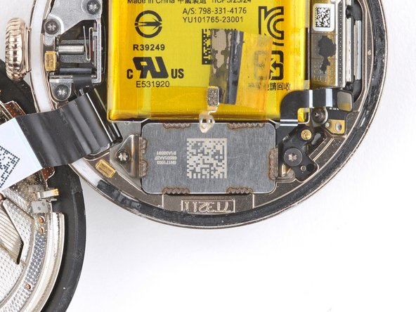

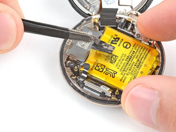

  12. Google Pixel Watch 2 Vibration Motor Replacement, Peel up the vibration motor cable tape: step 12, image 1 of 3 Google Pixel Watch 2 Vibration Motor Replacement, Peel up the vibration motor cable tape: step 12, image 2 of 3 Google Pixel Watch 2 Vibration Motor Replacement, Peel up the vibration motor cable tape: step 12, image 3 of 3
    • Tape secures the vibration motor cable and its cover to the battery.
    • Be careful not to puncture the battery—it can leak dangerous chemicals and catch fire.

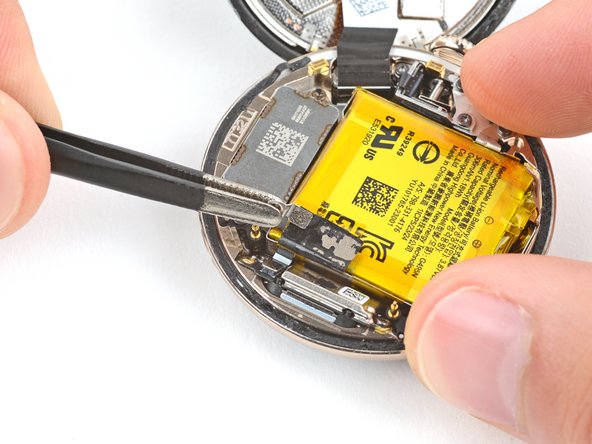

    • Use a pair of blunt nose tweezers to grip the vibration motor press connector cover.
    • Gently peel up the tape until the vibration motor cable is uncovered.
    • During reassembly, use the flat end of a spudger to push the black cover tape back into place.

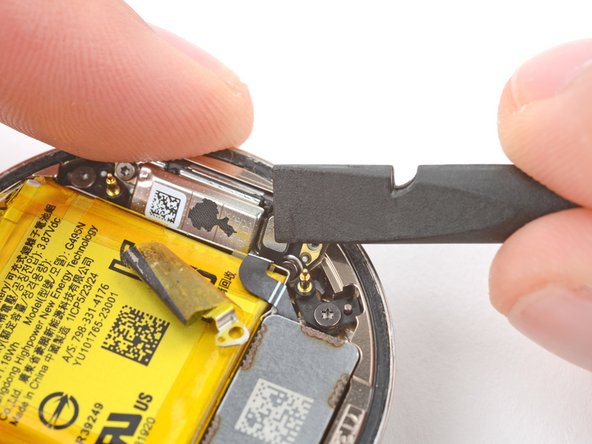

  13. Google Pixel Watch 2 Vibration Motor Replacement, Disconnect the vibration motor: step 13, image 1 of 3 Google Pixel Watch 2 Vibration Motor Replacement, Disconnect the vibration motor: step 13, image 2 of 3 Google Pixel Watch 2 Vibration Motor Replacement, Disconnect the vibration motor: step 13, image 3 of 3
    • Use the point of a spudger to pry up and disconnect the vibration motor press connector.
    • During reassembly, use the flat end of a spudger to reconnect the press connector.

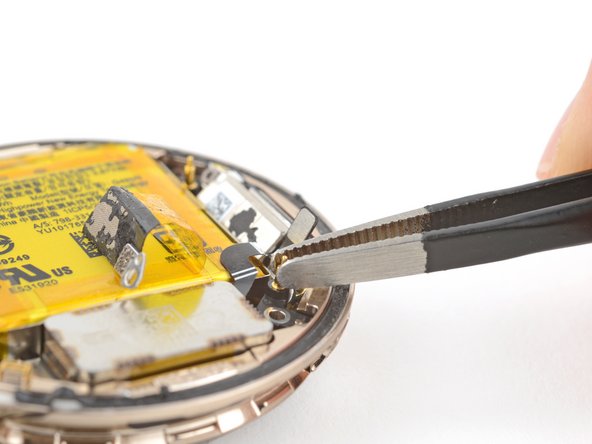

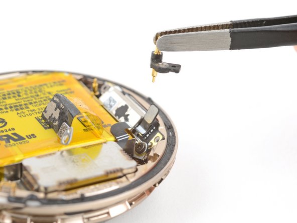

  15. Google Pixel Watch 2 Vibration Motor Replacement, Remove the grounding bracket: step 15, image 1 of 2 Google Pixel Watch 2 Vibration Motor Replacement, Remove the grounding bracket: step 15, image 2 of 2
    • Use blunt nose tweezers to lift the grounding bracket out of its recess and remove it.
    • During reassembly, use the smaller alignment cutout to orient the bracket.
  16. Google Pixel Watch 2 Vibration Motor Replacement, Remove the vibration motor: step 16, image 1 of 2 Google Pixel Watch 2 Vibration Motor Replacement, Remove the vibration motor: step 16, image 2 of 2
    • Remove the vibration motor.
