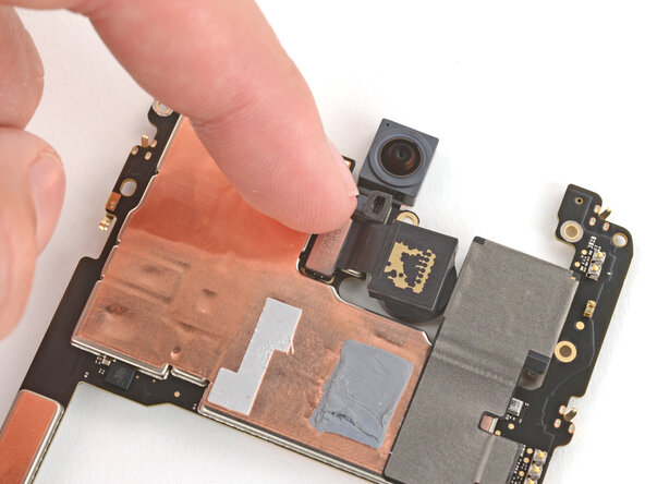

    1. Google Pixel 9a Ultrawide Camera Replacement, Install the ultrawide camera: step 28, image 1 of 3 Google Pixel 9a Ultrawide Camera Replacement, Install the ultrawide camera: step 28, image 2 of 3 Google Pixel 9a Ultrawide Camera Replacement, Install the ultrawide camera: step 28, image 3 of 3
      • Leave any lens caps or liners on the camera for now—they'll protect the lens during reassembly. You'll remove them before installing the back cover.
      • Put the ultrawide camera into place on the logic board, being careful not to smudge the lens.
      • Align the press connector over its socket and press down with your fingertip—first on one side, then the other—until it clicks into place.
      Ask FixBot

    11. Google Pixel 9a Ultrawide Camera Replacement, Flip up the logic board: step 39, image 1 of 3 Google Pixel 9a Ultrawide Camera Replacement, Flip up the logic board: step 39, image 2 of 3 Google Pixel 9a Ultrawide Camera Replacement, Flip up the logic board: step 39, image 3 of 3
      • Be careful not to smudge the cameras when handling the logic board.
      • Flip the logic board up so it's gently resting in its recess in the frame.
      • Remove the suction cup and lay your phone screen-side down.
