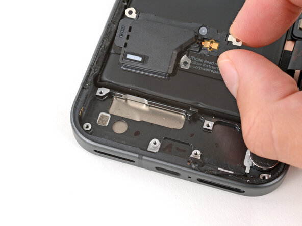

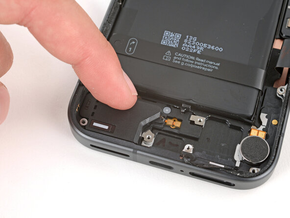

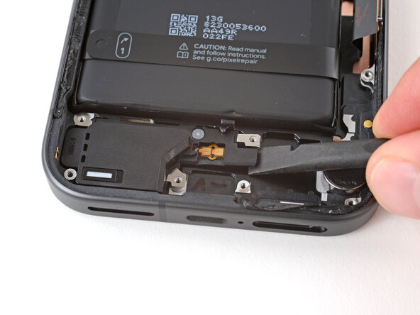

    1. Google Pixel 9a Loudspeaker Replacement, Remove the loudspeaker: step 27, image 1 of 3 Google Pixel 9a Loudspeaker Replacement, Remove the loudspeaker: step 27, image 2 of 3 Google Pixel 9a Loudspeaker Replacement, Remove the loudspeaker: step 27, image 3 of 3
      • Slide the flat end of a spudger under the plastic tab on the right side of the loudspeaker.
      • Twist the spudger to pry up and unclip the loudspeaker.
      Ask FixBot
    2. Google Pixel 9a Loudspeaker Replacement: step 28, image 1 of 2 Google Pixel 9a Loudspeaker Replacement: step 28, image 2 of 2
      • Remove the loudspeaker.
      Ask FixBot

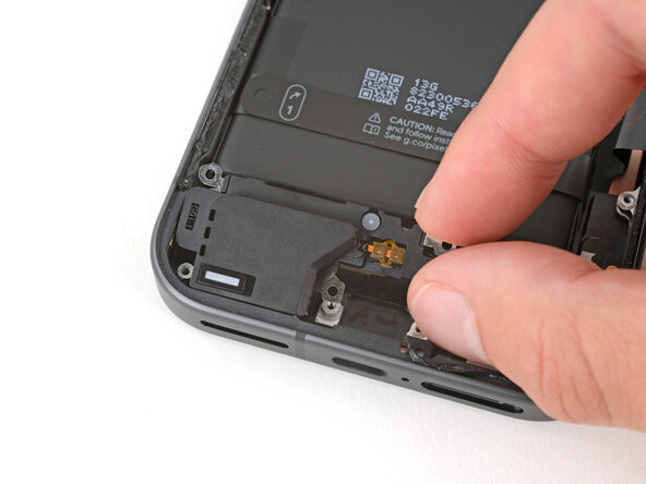

    1. Google Pixel 9a Loudspeaker Replacement, Install the loudspeaker: step 30, image 1 of 3 Google Pixel 9a Loudspeaker Replacement, Install the loudspeaker: step 30, image 2 of 3 Google Pixel 9a Loudspeaker Replacement, Install the loudspeaker: step 30, image 3 of 3
      • Put the loudspeaker into place at a slight downward angle so the speaker gasket goes into its cutout.
      • Press down firmly on the loudspeaker until it clicks into place.
