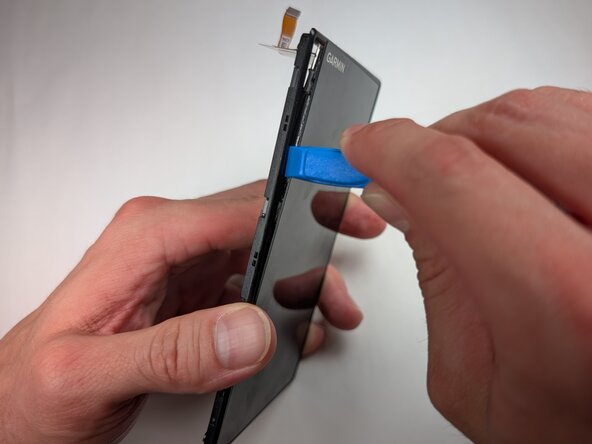

      • Use a T5 Torx screwdriver to remove the four 4.2 mm black screws from the back case.
      • Insert the plastic opening tool into the gap between the screen and case, and release the clips along the edges of the device.
      • Use opening picks along the perimeter to keep them separated until you can remove the screen.

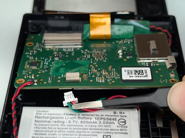

      • Gently separate the screen from the case and place the device flat on the surface.
      • Avoid pulling on the screen too forcefully, as the display ribbon cable is still connected to the motherboard.
      • Use a T5 Torx screwdriver to remove the four 3.8 mm silver screws from the motherboard.
      • Avoid scratching the motherboard when using the screwdriver, as this can damage the device.
      • Gently pry the motherboard up using the plastic opening tool.

      • Use your fingers or tweezers to disconnect the battery connector on the underside of the motherboard.
      • Avoid pulling on the cables.

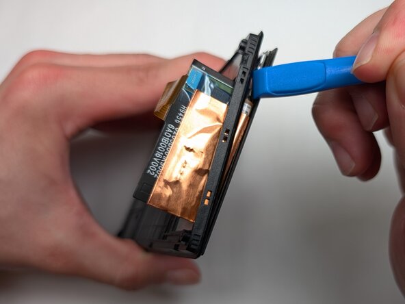

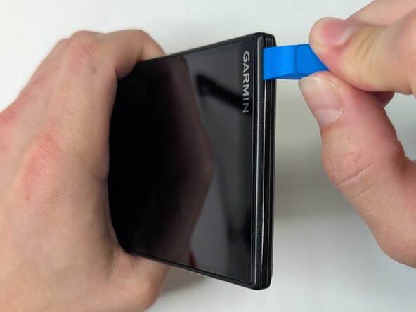

      • Insert a spudger or plastic opening tool into the gap between the screen and display frame.
      • Once a corner begins to lift, slowly slide the tool around the edges to release the clips securing them.
      • The screen is glass and if you use too much force it can shatter and crack the screen.
      • Separate the screen from the device.
