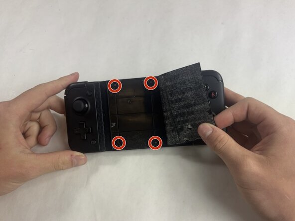

    2. GameSir X2 Pro USB-C Cable Replacement: step 2, image 1 of 2 GameSir X2 Pro USB-C Cable Replacement: step 2, image 2 of 2
      • Use a Phillips #000 screwdriver to remove the four 4.5 mm screws under the rubber pad.

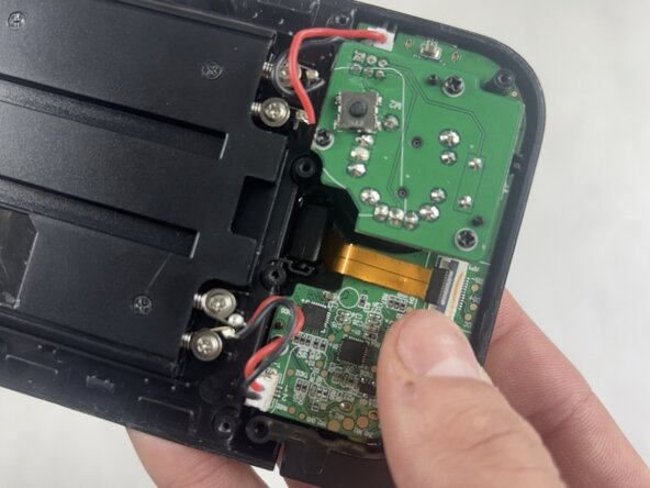

    7. GameSir X2 Pro USB-C Cable Replacement: step 7, image 1 of 3 GameSir X2 Pro USB-C Cable Replacement: step 7, image 2 of 3 GameSir X2 Pro USB-C Cable Replacement: step 7, image 3 of 3
      • Use a spudger or a clean fingernail to flip up the black locking flap.
      • Use the widest tool possible to avoid damaging the delicate hinge pins.
      • Use tweezers or your fingers to gently pull the cable out of its socket.
