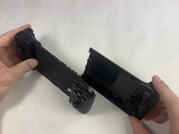

    4. GameSir X2 Pro Trigger Replacement: step 4, image 1 of 3 GameSir X2 Pro Trigger Replacement: step 4, image 2 of 3 GameSir X2 Pro Trigger Replacement: step 4, image 3 of 3
      • Use the Jimmy to pry the back cover of the controller, following the seam.
      • Some force is necessary, but be careful not to damage any of the clips holding the controller together.
      Ask FixBot
