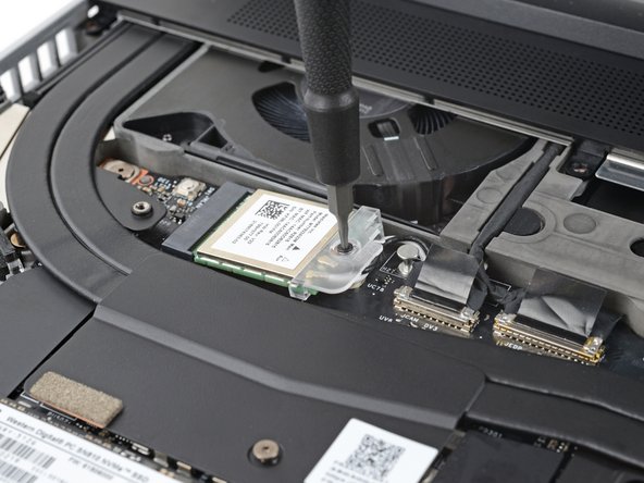

    1. Framework Laptop 16" Wi-Fi Card Replacement, Loosen the Wi-Fi card screw: step 14, image 1 of 2 Framework Laptop 16" Wi-Fi Card Replacement, Loosen the Wi-Fi card screw: step 14, image 2 of 2
      • Use a T5 Torx screwdriver to loosen the captive screw securing Wi-Fi card.
      • The Wi-Fi card might pop up at a shallow angle when you loosen the screw.

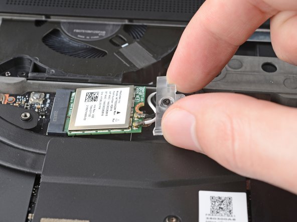

    2. Framework Laptop 16" Wi-Fi Card Replacement, Remove the Wi-Fi card: step 15, image 1 of 2 Framework Laptop 16" Wi-Fi Card Replacement, Remove the Wi-Fi card: step 15, image 2 of 2
      • Slide the clear Wi-Fi card cover straight off the card and remove it.
