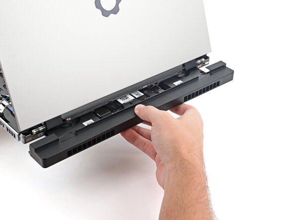

    4. Framework Laptop 16" Ventilation Plate Replacement, Remove the ventilation plate: step 22, image 1 of 3 Framework Laptop 16" Ventilation Plate Replacement, Remove the ventilation plate: step 22, image 2 of 3 Framework Laptop 16" Ventilation Plate Replacement, Remove the ventilation plate: step 22, image 3 of 3
      • The ventilation plate is held in place with magnets.
      • Lift the bottom of the ventilation plate and pull it away from the laptop until the magnets release.
      • Remove the ventilation plate.
      Ask FixBot
