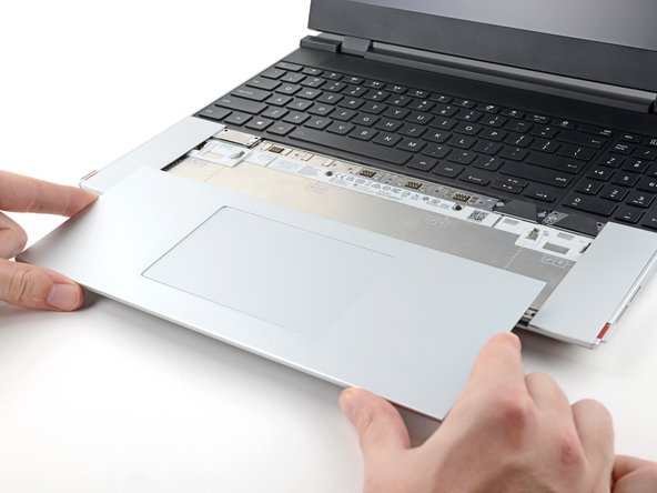

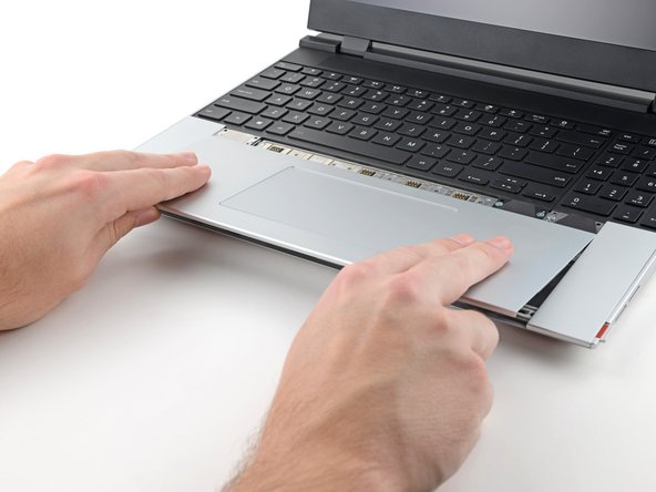

    1. Framework Laptop 16" Touchpad Replacement, Remove the touchpad: step 3, image 1 of 3 Framework Laptop 16" Touchpad Replacement, Remove the touchpad: step 3, image 2 of 3 Framework Laptop 16" Touchpad Replacement, Remove the touchpad: step 3, image 3 of 3
      • Use your fingers to slide the touchpad toward the bottom edge of the laptop and disconnect it.
      • If you're having trouble, check if the Input Module latches are properly unlocked.
      • Lift the touchpad and remove it.
      • During reassembly, perform the following:
      • Place the touchpad flat on its cutout so its clips are properly aligned.
      • Press the touchpad down and slide it into place so it lines up evenly with the bottom edge of the laptop.
