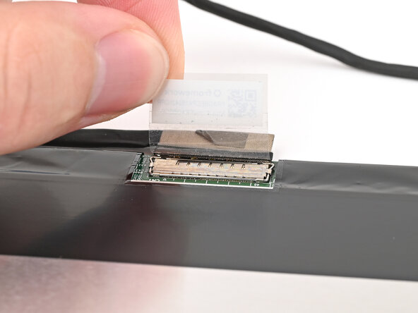

    1. Framework Laptop 16 eDP Cable Replacement, Disconnect the eDP cable: step 28, image 1 of 3 Framework Laptop 16 eDP Cable Replacement, Disconnect the eDP cable: step 28, image 2 of 3 Framework Laptop 16 eDP Cable Replacement, Disconnect the eDP cable: step 28, image 3 of 3
      • Rest your display facedown on a flat, clean work surface.
      • Use your fingers to flip up the plastic tab and access the connector underneath.
      Ask FixBot
