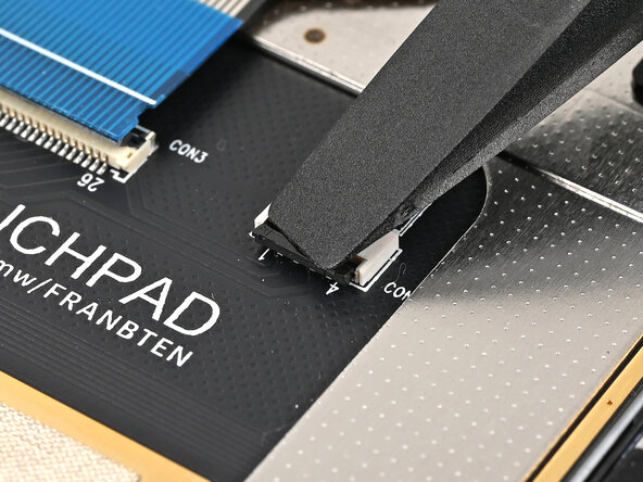

    2. Framework Laptop 13 Touchpad Replacement, Disconnect the Fingerprint Reader Cable: step 8, image 1 of 2 Framework Laptop 13 Touchpad Replacement, Disconnect the Fingerprint Reader Cable: step 8, image 2 of 2
      • Use the flat end of your Framework Screwdriver, or a clean fingernail, to lift up the locking tab on the Fingerprint Reader ZIF connector on the touchpad.

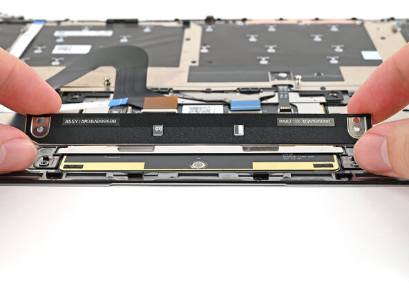

    9. Framework Laptop 13 Touchpad Replacement, Remove the touchpad bracket: step 15, image 1 of 3 Framework Laptop 13 Touchpad Replacement, Remove the touchpad bracket: step 15, image 2 of 3 Framework Laptop 13 Touchpad Replacement, Remove the touchpad bracket: step 15, image 3 of 3
      • Lift the touchpad bracket towards the top of the Input Cover to release its two metal clips.
      • Remove the touchpad bracket.

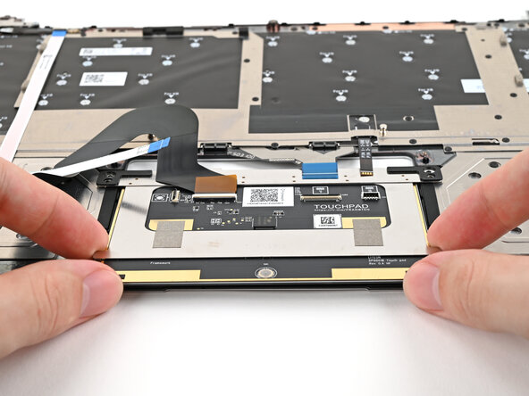

    11. Framework Laptop 13 Touchpad Replacement, Remove the touchpad: step 17, image 1 of 3 Framework Laptop 13 Touchpad Replacement, Remove the touchpad: step 17, image 2 of 3 Framework Laptop 13 Touchpad Replacement, Remove the touchpad: step 17, image 3 of 3
      • Use your fingers to lift the bottom edge of the touchpad and pull it towards the bottom edge of the Input Cover to release its two metal clips.
