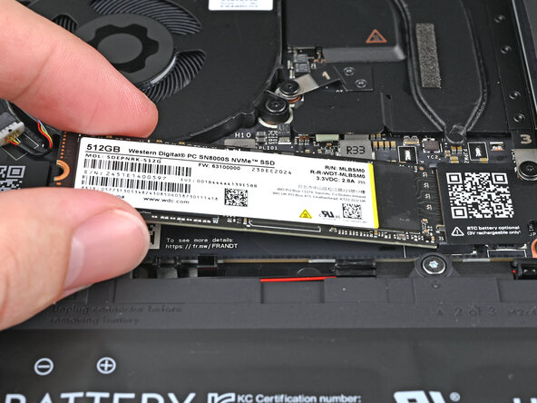

    1. Framework Laptop 13 Storage Replacement, Install the SSD: step 10, image 1 of 2 Framework Laptop 13 Storage Replacement, Install the SSD: step 10, image 2 of 2
      • Hold the SSD by its edges. Don't touch the gold contacts with your fingers. If you do, wipe the contacts with a clean, lint-free cloth to remove any finger oils.
      • Insert the SSD into the socket at a shallow angle. The gold contacts should mostly be covered by the socket.
      • The SSD fits into the socket in one orientation. If it doesn't feel like it fits, try flipping the module.

    2. Framework Laptop 13 Storage Replacement: step 11, image 1 of 2 Framework Laptop 13 Storage Replacement: step 11, image 2 of 2
      • While holding the SSD flat to the Mainboard, use your Framework Screwdriver to install the 3.0 mm‑long T5 Torx screw securing the SSD.
