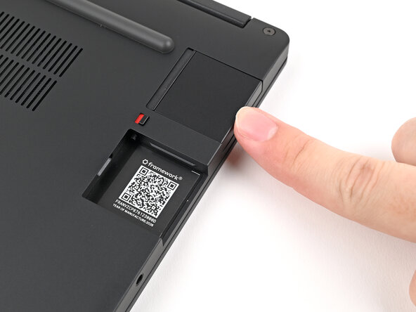

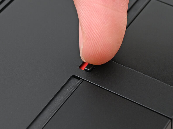

    2. Framework Laptop 13 Pro Mainboard Replacement, Remove the Expansion Cards: step 3, image 1 of 2 Framework Laptop 13 Pro Mainboard Replacement, Remove the Expansion Cards: step 3, image 2 of 2
      • Use your finger to flip the Expansion Card latches into the unlocked position.
      • The latch displays a red bar when it's unlocked.
      Ask FixBot

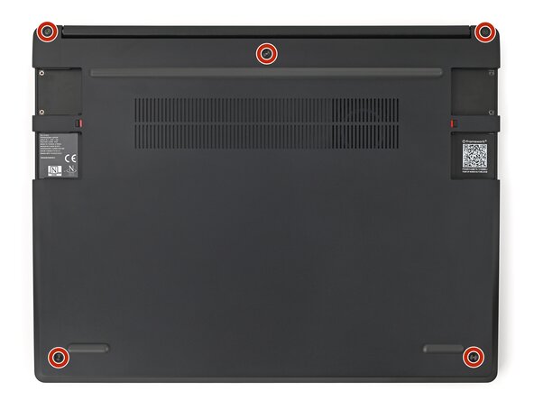

    1. Framework Laptop 13 Pro Mainboard Replacement, Loosen the Input Cover screws: step 5, image 1 of 2 Framework Laptop 13 Pro Mainboard Replacement, Loosen the Input Cover screws: step 5, image 2 of 2
      • Use your Framework Screwdriver to loosen the five captive T5 Torx screws securing the Input Cover.

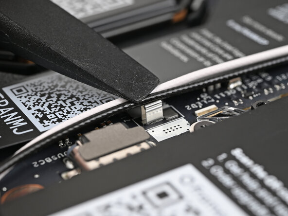

    1. Framework Laptop 13 Pro Mainboard Replacement, Disconnect the Battery: step 10, image 1 of 2 Framework Laptop 13 Pro Mainboard Replacement, Disconnect the Battery: step 10, image 2 of 2
      • When disconnecting the Battery, make sure you slide its connector straight out of its socket or else you risk bending the socket's pins.
      • Use your fingers to grip the edges of the Battery connector and slide it straight out of its socket to disconnect the Battery.

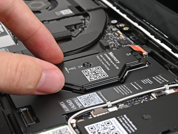

    1. Framework Laptop 13 Pro Mainboard Replacement, Loosen the LPCAMM2 Memory Cover: step 11, image 1 of 2 Framework Laptop 13 Pro Mainboard Replacement, Loosen the LPCAMM2 Memory Cover: step 11, image 2 of 2
      • Use your Framework Screwdriver to loosen the captive T5 Torx screws securing the LPCAMM2 Memory Cover in reverse order from 3–1.
      Ask FixBot
    2. Framework Laptop 13 Pro Mainboard Replacement, Remove the LPCAMM2 Memory Cover: step 12, image 1 of 2 Framework Laptop 13 Pro Mainboard Replacement, Remove the LPCAMM2 Memory Cover: step 12, image 2 of 2
      • Lift the LPCAMM2 Memory Cover straight off the memory and remove it.
      Ask FixBot
    1. Framework Laptop 13 Pro Mainboard Replacement, Remove the LPCAMM2 Memory: step 13, image 1 of 2 Framework Laptop 13 Pro Mainboard Replacement, Remove the LPCAMM2 Memory: step 13, image 2 of 2
      • Grip the LPCAMM2 module by its edges and lift it straight off its alignment pegs to remove it.
      • Avoid touching the Interposer below the module. If the Interposer accidentally shifts, grab it by its edges to place it back into its alignment pegs.
      • Make sure there's no dust or debris on top of the Interposer before continuing.

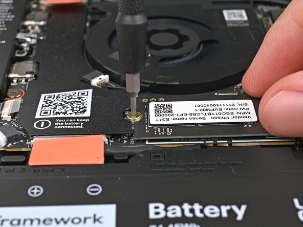

    1. Framework Laptop 13 Pro Mainboard Replacement, Remove the SSD screw: step 14, image 1 of 2 Framework Laptop 13 Pro Mainboard Replacement, Remove the SSD screw: step 14, image 2 of 2
      • Use your Framework Screwdriver to remove the 3.0 mm‑long T5 Torx screw securing the SSD.
      • The SSD might pop up at a shallow angle when you remove the screw.
      Ask FixBot

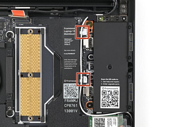

    1. Framework Laptop 13 Pro Mainboard Replacement, Disconnect the Speakers: step 16, image 1 of 2 Framework Laptop 13 Pro Mainboard Replacement, Disconnect the Speakers: step 16, image 2 of 2
      • Use your fingers to grip the edges of the Speakers Cable connector.
      • Pull the connector straight out of its socket to disconnect it.
      Ask FixBot

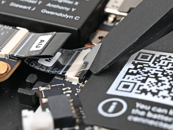

    2. Framework Laptop 13 Pro Mainboard Replacement, Disconnect the Audio Board: step 17, image 1 of 2 Framework Laptop 13 Pro Mainboard Replacement, Disconnect the Audio Board: step 17, image 2 of 2
      • Use the flat end of your Framework Screwdriver, or a clean fingernail, to lift up the locking tab on the Audio Board ZIF connector on the Mainboard.
      Ask FixBot
    3. Framework Laptop 13 Pro Mainboard Replacement: step 18, image 1 of 2 Framework Laptop 13 Pro Mainboard Replacement: step 18, image 2 of 2
      • Use your fingers to lightly grip the Audio Board cable and slide it straight out of its socket.
      Ask FixBot

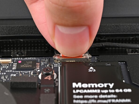

    4. Framework Laptop 13 Pro Mainboard Replacement, Disconnect the Display eDP Cable: step 19, image 1 of 2 Framework Laptop 13 Pro Mainboard Replacement, Disconnect the Display eDP Cable: step 19, image 2 of 2
      • Grip the Display eDP Cable connector by its pull tab and lift up to disconnect it.
      Ask FixBot

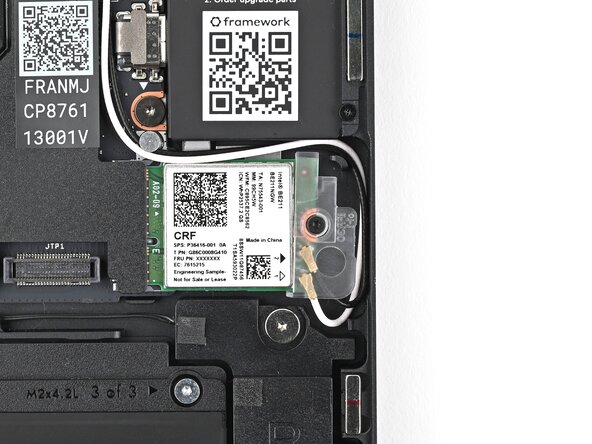

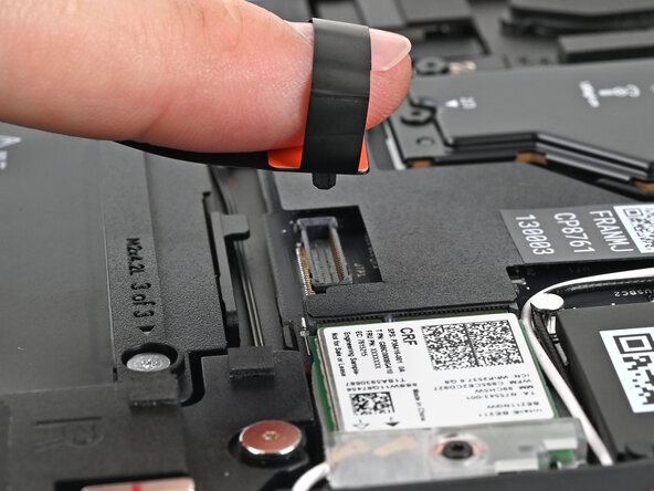

    7. Framework Laptop 13 Pro Mainboard Replacement, Loosen the Wi-Fi module screw: step 22, image 1 of 2 Framework Laptop 13 Pro Mainboard Replacement, Loosen the Wi-Fi module screw: step 22, image 2 of 2
      • Use your Framework Screwdriver to loosen the captive T5 Torx screw securing the Wi-Fi module.
      • The module might pop up at a shallow angle when you loosen the screw.
      Ask FixBot
    8. Framework Laptop 13 Pro Mainboard Replacement, Disconnect the Wi-Fi module: step 23, image 1 of 3 Framework Laptop 13 Pro Mainboard Replacement, Disconnect the Wi-Fi module: step 23, image 2 of 3 Framework Laptop 13 Pro Mainboard Replacement, Disconnect the Wi-Fi module: step 23, image 3 of 3
      • Grip the end of the Wi-Fi module with the screw hole and slide it out of its socket.
      • Don't pull the module too far from its socket, as it's still connected by two cables.
      • Keep the plastic bracket attached to the module to prevent the cables from disconnecting.
      • Position the Wi-Fi module to the right of the laptop to keep it out of the way of the Mainboard.

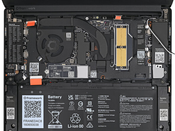

    9. Framework Laptop 13 Pro Mainboard Replacement, Remove the Mainboard screws: step 24, image 1 of 2 Framework Laptop 13 Pro Mainboard Replacement, Remove the Mainboard screws: step 24, image 2 of 2
      • Use your Framework Screwdriver to remove the five 1.5 mm‑long T5 Torx screws securing the Mainboard.
      • Since these screws aren't captive, put them in a safe place.
      Ask FixBot

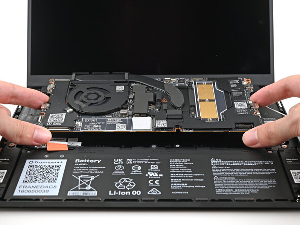

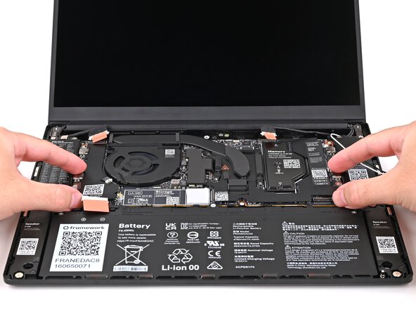

    10. Framework Laptop 13 Pro Mainboard Replacement, Remove the Mainboard: step 25, image 1 of 3 Framework Laptop 13 Pro Mainboard Replacement, Remove the Mainboard: step 25, image 2 of 3 Framework Laptop 13 Pro Mainboard Replacement, Remove the Mainboard: step 25, image 3 of 3
      • Use your fingers to lift the bottom edge of the Mainboard enough to grip its edges.
      • Lift the Mainboard off its alignment pegs and remove it.
      Ask FixBot

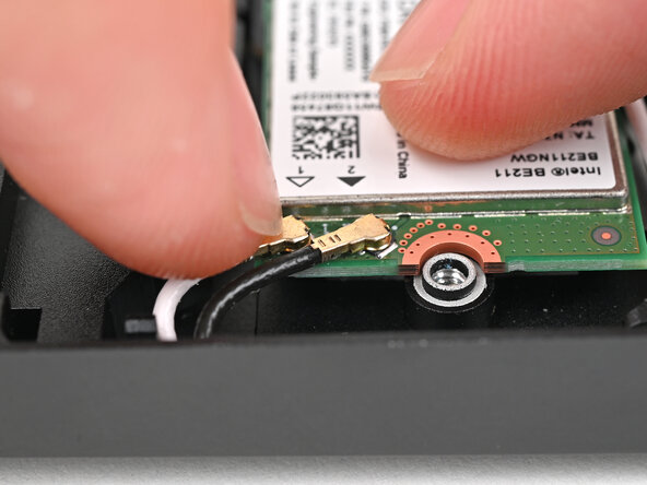

    6. Framework Laptop 13 Pro Mainboard Replacement, Reconnect the Wi-Fi module: step 32, image 1 of 3 Framework Laptop 13 Pro Mainboard Replacement, Reconnect the Wi-Fi module: step 32, image 2 of 3 Framework Laptop 13 Pro Mainboard Replacement, Reconnect the Wi-Fi module: step 32, image 3 of 3
      • If the Antenna Cables got accidentally disconnected, follow this step to reconnect them. Otherwise, skip this step to continue the guide normally.
      • Hold the Wi-Fi module down with your finger.
      • Position the black antenna cable connector over the left Wi-Fi module's coaxial socket.
      • If you're unsure which cable goes where, refer to the arrows on the Wi-Fi module for which color cable matches with its connector.
      • Tweezers can help position the connector.
      • Use your finger to press the connector into place. You should feel a faint click, and the cable will stay attached to the socket by itself.
      • These connectors are very delicate! If the connector doesn't feel like it's clicking in place, reposition the connector and try again.
      • Repeat the procedure with the white antenna cable.

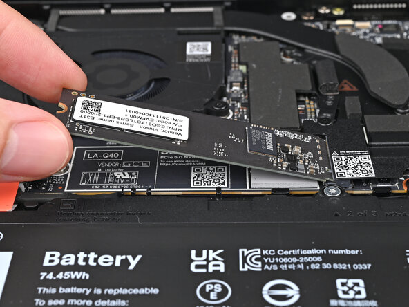

    1. Framework Laptop 13 Pro Mainboard Replacement, Install the SSD: step 38, image 1 of 2 Framework Laptop 13 Pro Mainboard Replacement, Install the SSD: step 38, image 2 of 2
      • Hold the SSD by its edges. Don't touch the gold contacts with your fingers. If you do, wipe the contacts with a clean, lint-free cloth to remove any finger oils.
      • Insert the SSD into the socket at a shallow angle. The gold contacts should mostly be covered by the socket.
      • The SSD fits into the socket in one orientation. If it doesn't feel like it fits, try flipping the module.

    5. Framework Laptop 13 Pro Mainboard Replacement, Place the LPCAMM2 Memory Cover: step 44, image 1 of 2 Framework Laptop 13 Pro Mainboard Replacement, Place the LPCAMM2 Memory Cover: step 44, image 2 of 2
      • Place the LPCAMM2 Memory Cover on top of the memory, making sure its screws align with the screw holes.
      • The cover should lay flat when aligned properly.

    6. Framework Laptop 13 Pro Mainboard Replacement, Tighten the Input Cover screws: step 53, image 1 of 2 Framework Laptop 13 Pro Mainboard Replacement, Tighten the Input Cover screws: step 53, image 2 of 2
      • Use your Framework Screwdriver to tighten the five captive T5 Torx screws securing the Input Cover.
      • Don't overtighten the screws—just make sure they're snug.
