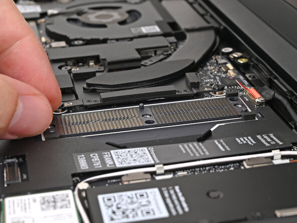

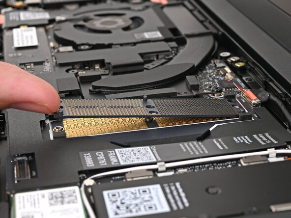

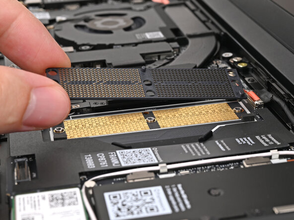

    1. Framework Laptop 13 Pro LPCAMM2 Memory Interposer Replacement, Remove the LPCAMM2 Memory Interposer: step 10, image 1 of 3 Framework Laptop 13 Pro LPCAMM2 Memory Interposer Replacement, Remove the LPCAMM2 Memory Interposer: step 10, image 2 of 3 Framework Laptop 13 Pro LPCAMM2 Memory Interposer Replacement, Remove the LPCAMM2 Memory Interposer: step 10, image 3 of 3
      • Be extremely careful when handling the Interposer, as its pins can break easily. Only grip its edges to avoid touching its pins.
      • Use a fingernail to lift up the bottom edge of the Interposer until you can grip its edges with your fingers.
      • Lift the Interposer straight off its alignment pegs and remove it.
      • Avoid pressing or bending the pins against the Mainboard as you lift.
