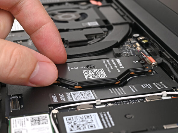

    1. Framework Laptop 13 Pro LPCAMM2 Memory Cover Replacement, Loosen the LPCAMM2 Memory Cover: step 7, image 1 of 2 Framework Laptop 13 Pro LPCAMM2 Memory Cover Replacement, Loosen the LPCAMM2 Memory Cover: step 7, image 2 of 2
      • Use your Framework Screwdriver to loosen the captive T5 Torx screws securing the LPCAMM2 Memory Cover in reverse order from 3–1.
      Ask FixBot
    2. Framework Laptop 13 Pro LPCAMM2 Memory Cover Replacement, Remove the LPCAMM2 Memory Cover: step 8, image 1 of 2 Framework Laptop 13 Pro LPCAMM2 Memory Cover Replacement, Remove the LPCAMM2 Memory Cover: step 8, image 2 of 2
      • Lift the LPCAMM2 Memory Cover straight off the memory and remove it.
      Ask FixBot
    1. Framework Laptop 13 Pro LPCAMM2 Memory Cover Replacement, Disassembly complete: step 9, image 1 of 1
      • Congratulations on completing disassembly! The remaining steps will show how to reassemble your Framework Laptop.

    1. Framework Laptop 13 Pro LPCAMM2 Memory Cover Replacement, Place the LPCAMM2 Memory Cover: step 10, image 1 of 2 Framework Laptop 13 Pro LPCAMM2 Memory Cover Replacement, Place the LPCAMM2 Memory Cover: step 10, image 2 of 2
      • Place the LPCAMM2 Memory Cover on top of the memory, making sure its screws align with the screw holes.
      • The cover should lay flat when aligned properly.
      Ask FixBot
    2. Framework Laptop 13 Pro LPCAMM2 Memory Cover Replacement, Tighten the LPCAMM2 Memory Cover: step 11, image 1 of 2 Framework Laptop 13 Pro LPCAMM2 Memory Cover Replacement, Tighten the LPCAMM2 Memory Cover: step 11, image 2 of 2
      • Use your Framework Screwdriver to tighten the captive T5 Torx screws securing the LPCAMM2 Memory Cover in order from 1–3.
      • Make sure the screws are snug enough to create proper contact between the memory and the Mainboard.
