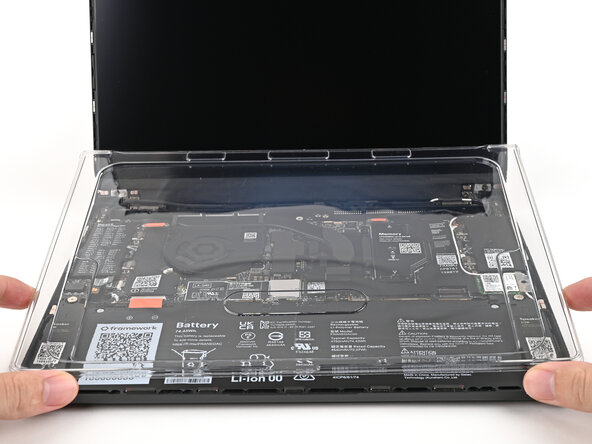

    2. Framework Laptop 13 Pro DIY Edition Quick Start Guide, Remove the plastic cover: step 2, image 1 of 3 Framework Laptop 13 Pro DIY Edition Quick Start Guide, Remove the plastic cover: step 2, image 2 of 3 Framework Laptop 13 Pro DIY Edition Quick Start Guide, Remove the plastic cover: step 2, image 3 of 3
      • Open the laptop and remove the plastic cover.
      • The protective cover is made of post-consumer recycled PET and is highly recyclable. Please recycle this with your household recycling.

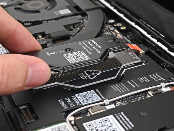

    4. Framework Laptop 13 Pro DIY Edition Quick Start Guide, Remove the LPCAMM2 Memory Cover: step 4, image 1 of 2 Framework Laptop 13 Pro DIY Edition Quick Start Guide, Remove the LPCAMM2 Memory Cover: step 4, image 2 of 2
      • Lift the LPCAMM2 Memory Cover straight off the memory and remove it.
      Ask FixBot

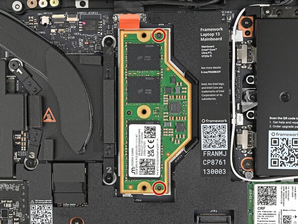

    6. Framework Laptop 13 Pro DIY Edition Quick Start Guide, Place the LPCAMM2 Memory: step 6, image 1 of 3 Framework Laptop 13 Pro DIY Edition Quick Start Guide, Place the LPCAMM2 Memory: step 6, image 2 of 3 Framework Laptop 13 Pro DIY Edition Quick Start Guide, Place the LPCAMM2 Memory: step 6, image 3 of 3
      • Place the LPCAMM2 module on top of the Interposer, making sure it slots into its alignment pegs.
      Ask FixBot

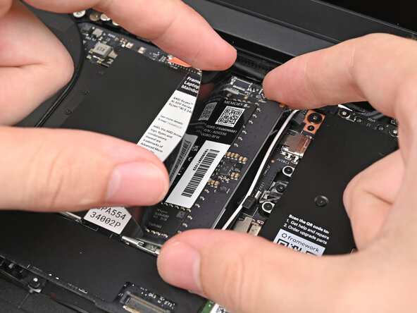

    9. Framework Laptop 13 Pro DIY Edition Quick Start Guide, Install the DDR5 Memory: step 9, image 1 of 3 Framework Laptop 13 Pro DIY Edition Quick Start Guide, Install the DDR5 Memory: step 9, image 2 of 3 Framework Laptop 13 Pro DIY Edition Quick Start Guide, Install the DDR5 Memory: step 9, image 3 of 3
      • Hold the memory module by its edges. Don't touch the gold contacts with your fingers. If you do, wipe the contacts with a clean, lint-free cloth to remove any finger oils.
      • While holding up the black flap covering the left memory module labeled ("Channel 0"), orient the module with its label facing down and align the gold contacts with the socket.
      • Insert the contact edge into the socket at a shallow angle. The gold contacts should mostly be covered by the socket.
      • Press the edges of the memory module down until the side clips lock it in place.

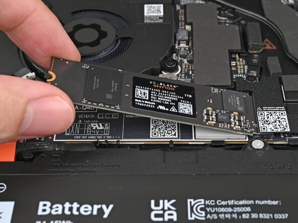

    12. Framework Laptop 13 Pro DIY Edition Quick Start Guide, Install the SSD: step 12, image 1 of 2 Framework Laptop 13 Pro DIY Edition Quick Start Guide, Install the SSD: step 12, image 2 of 2
      • Hold the SSD by its edges. Don't touch the gold contacts with your fingers. If you do, wipe the contacts with a clean, lint-free cloth to remove any finger oils.
      • Insert the SSD into the socket at a shallow angle. The gold contacts should mostly be covered by the socket.
      • The SSD fits into the socket in one orientation. If it doesn't feel like it fits, try flipping the module.

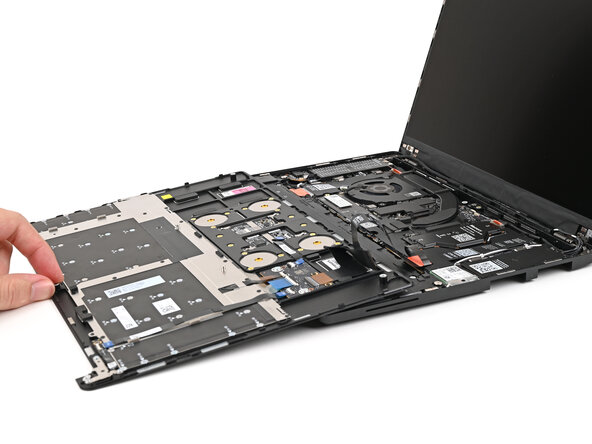

    14. Framework Laptop 13 Pro DIY Edition Quick Start Guide, Position the Input Cover: step 14, image 1 of 2 Framework Laptop 13 Pro DIY Edition Quick Start Guide, Position the Input Cover: step 14, image 2 of 2
      • Position the Input Cover, Keyboard down, on top of the laptop so it just covers the Battery.
      • This allows the Touchpad Cable to be folded over and reconnected without straining it.
      Ask FixBot

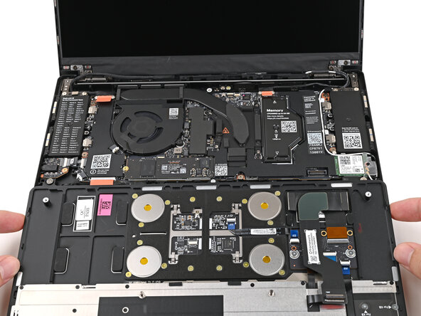

    15. Framework Laptop 13 Pro DIY Edition Quick Start Guide, Connect the Touchpad Cable: step 15, image 1 of 2 Framework Laptop 13 Pro DIY Edition Quick Start Guide, Connect the Touchpad Cable: step 15, image 2 of 2
      • Insert your finger into the Touchpad Cable press connector loop.
      • Align the press connector over its socket and press down with your finger.
      • You should hear it "click" into place. If you're having trouble, reposition it and try again. Don't try to force the connector into place.
      Ask FixBot

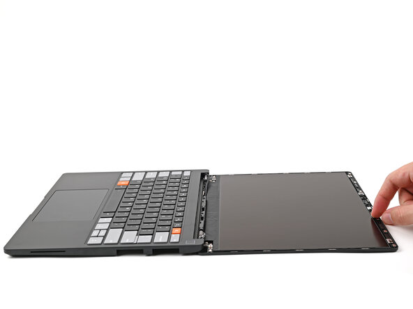

    18. Framework Laptop 13 Pro DIY Edition Quick Start Guide, Reposition the laptop: step 18, image 1 of 2 Framework Laptop 13 Pro DIY Edition Quick Start Guide, Reposition the laptop: step 18, image 2 of 2
      • Open the laptop so the screen sits flat on your work surface.
      Ask FixBot
    19. Framework Laptop 13 Pro DIY Edition Quick Start Guide, Check the cables: step 19, image 1 of 2 Framework Laptop 13 Pro DIY Edition Quick Start Guide, Check the cables: step 19, image 2 of 2
      • Before continuing, check if the cables next to the hinges are routed properly:
      • The Display Cable should be routed just above the hinge without any large gaps.
      • The Display Cable should be routed between the metal clips.
      • The Webcam Cable should be routed just above the hinge without any large gaps and shouldn't overlap with the Antenna Cables.
      • If the cables aren't routed properly, the Bezel won't sit flat and you risk damaging the Bezel and the Display during reassembly.
      Ask FixBot

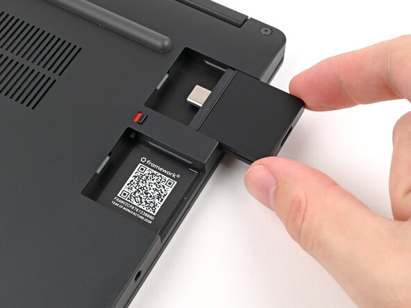

    25. Framework Laptop 13 Pro DIY Edition Quick Start Guide, Install the Expansion Cards: step 25, image 1 of 3 Framework Laptop 13 Pro DIY Edition Quick Start Guide, Install the Expansion Cards: step 25, image 2 of 3 Framework Laptop 13 Pro DIY Edition Quick Start Guide, Install the Expansion Cards: step 25, image 3 of 3
      • For Expansion Card compatibility, check here.
      • Slide an Expansion Card into an Expansion Card slot.
      • You don't need to unlock the latch to install the Expansion Cards—only when you want to remove them.
      • The Expansion Cards should click into place, and the front edge should be flush with the laptop.
      • Repeat for the remaining Expansion Cards along that edge.

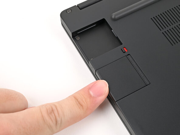

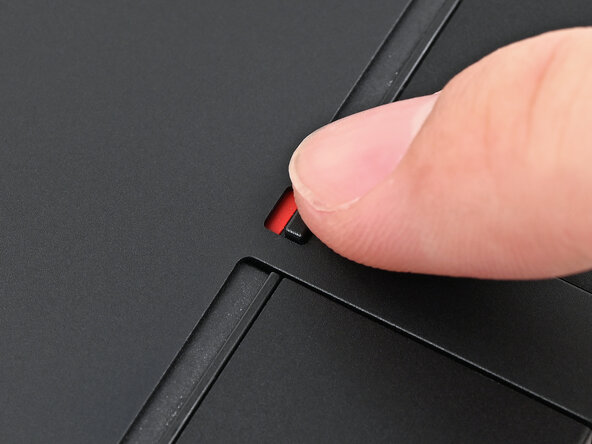

    26. Framework Laptop 13 Pro DIY Edition Quick Start Guide: step 26, image 1 of 2 Framework Laptop 13 Pro DIY Edition Quick Start Guide: step 26, image 2 of 2
      • If there's a red bar showing under the Expansion Card latch, use your finger to flip the latch and lock the row of Expansion Cards above it.
      • Locking an Expansion Card helps keep it in place when you unplug cables from it.
      Ask FixBot
    27. Framework Laptop 13 Pro DIY Edition Quick Start Guide: step 27, image 1 of 3 Framework Laptop 13 Pro DIY Edition Quick Start Guide: step 27, image 2 of 3 Framework Laptop 13 Pro DIY Edition Quick Start Guide: step 27, image 3 of 3
      • Repeat the previous two steps for the other row of Expansion Cards.
      Ask FixBot
