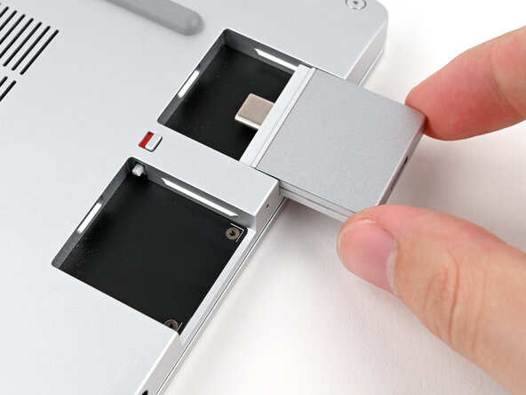

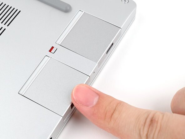

    1. Framework Laptop 13 Pro Bottom Cover Upgrade Kit, Remove the Expansion Cards: step 2, image 1 of 2 Framework Laptop 13 Pro Bottom Cover Upgrade Kit, Remove the Expansion Cards: step 2, image 2 of 2
      • While pressing down the release button, grip the lip of the Expansion Card and pull it out of its slot to release it.
      • This might take some initial force. If you're having trouble, make sure you're fully pressing down the release button.
      Ask FixBot
    2. Framework Laptop 13 Pro Bottom Cover Upgrade Kit: step 3, image 1 of 2 Framework Laptop 13 Pro Bottom Cover Upgrade Kit: step 3, image 2 of 2
      • Slide the Expansion Card out of its slot and remove it.
      • Remove the remaining Expansion Cards.

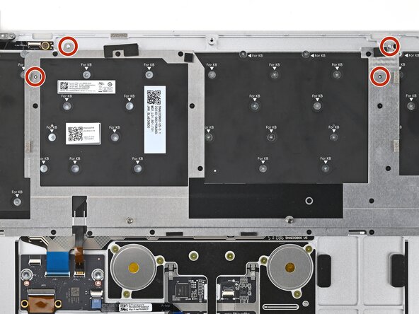

    1. Framework Laptop 13 Pro Bottom Cover Upgrade Kit, Loosen the Input Cover screws: step 4, image 1 of 2 Framework Laptop 13 Pro Bottom Cover Upgrade Kit, Loosen the Input Cover screws: step 4, image 2 of 2
      • Use your Framework Screwdriver to loosen the five captive T5 Torx screws securing the Input Cover.
      • The screw will make an audible "clicking" sound once it's fully loosened.

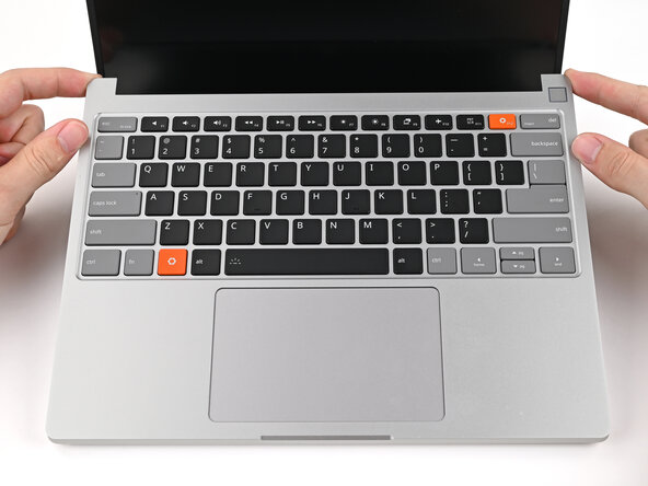

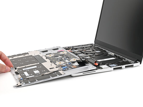

    2. Framework Laptop 13 Pro Bottom Cover Upgrade Kit, Lift the Input Cover: step 5, image 1 of 2 Framework Laptop 13 Pro Bottom Cover Upgrade Kit, Lift the Input Cover: step 5, image 2 of 2
      • Flip over the laptop and open it.
      • Use your fingers to lift the Input Cover up and release it from its magnets.
      • Don't fully remove the Input Cover yet, as it's still attached by the Touchpad Cable.
      • If you're having trouble lifting the Input Cover, you can leverage the gap at the bottom right corner to get your fingers fully under it.

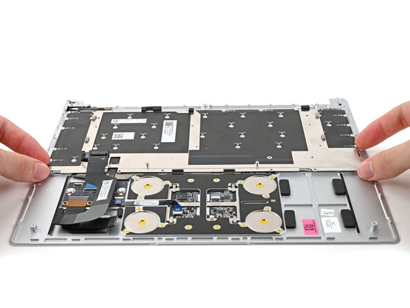

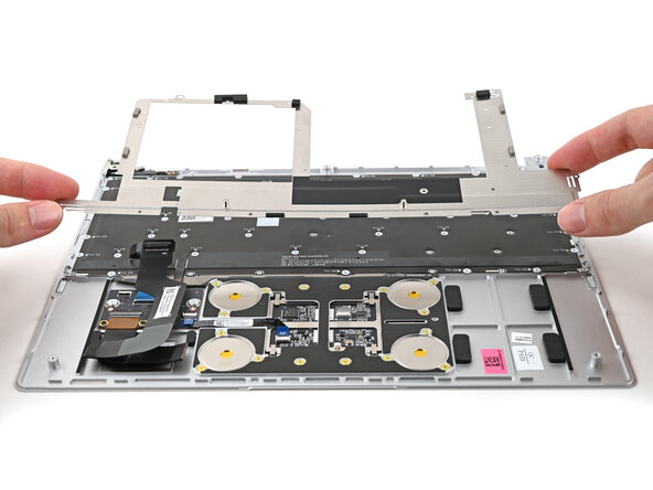

    3. Framework Laptop 13 Pro Bottom Cover Upgrade Kit, Flip over the Input Cover: step 6, image 1 of 2 Framework Laptop 13 Pro Bottom Cover Upgrade Kit, Flip over the Input Cover: step 6, image 2 of 2
      • Flip the top of the Input Cover so the Keyboard is facing down.
      • Rest the Input Cover over the Battery, making sure the Touchpad Cable isn't being strained.
      • If the LEDs on the left and right sides of the Mainboard are flashing, then your laptop is still powered on. Make sure your laptop is completely powered off before continuing.
      Ask FixBot

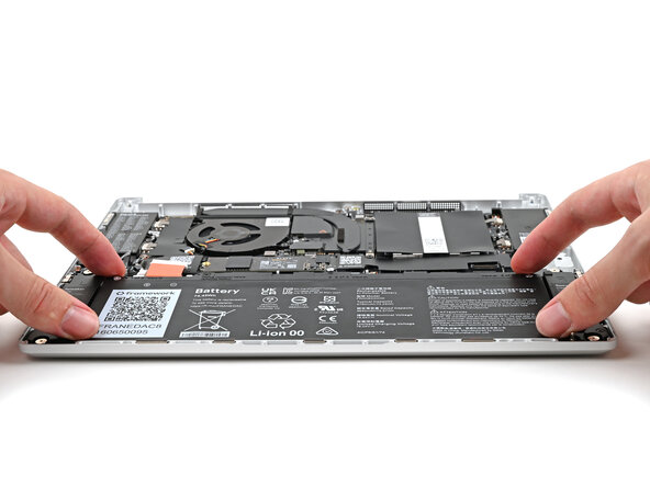

    1. Framework Laptop 13 Pro Bottom Cover Upgrade Kit, Disconnect the Battery: step 9, image 1 of 2 Framework Laptop 13 Pro Bottom Cover Upgrade Kit, Disconnect the Battery: step 9, image 2 of 2
      • When disconnecting the Battery, make sure you slide its connector straight out of its socket or else you risk bending the socket's pins.
      • Use your fingers to grip the edges of the Battery connector and slide it straight out of its socket to disconnect the Battery.

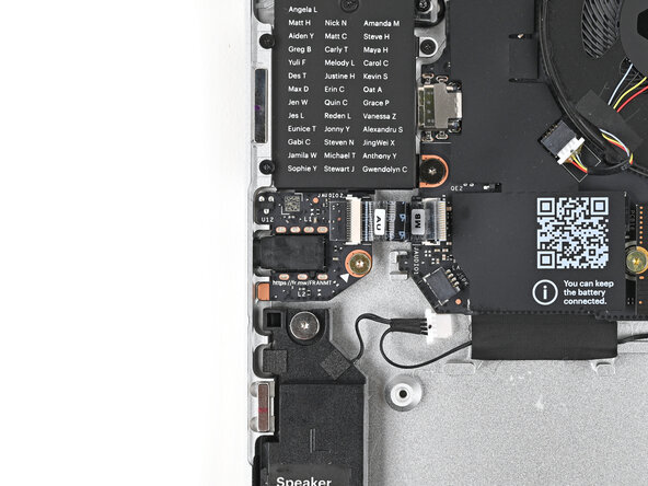

    2. Framework Laptop 13 Pro Bottom Cover Upgrade Kit, Disconnect the Audio Board: step 11, image 1 of 2 Framework Laptop 13 Pro Bottom Cover Upgrade Kit, Disconnect the Audio Board: step 11, image 2 of 2
      • Use the flat end of your Framework Screwdriver, or a clean fingernail, to lift up the locking tab on the Audio Board ZIF connector on the Mainboard.
      Ask FixBot
    3. Framework Laptop 13 Pro Bottom Cover Upgrade Kit: step 12, image 1 of 2 Framework Laptop 13 Pro Bottom Cover Upgrade Kit: step 12, image 2 of 2
      • Use your fingers to lightly grip the Audio Board cable and slide it straight out of its socket.
      Ask FixBot

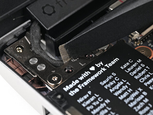

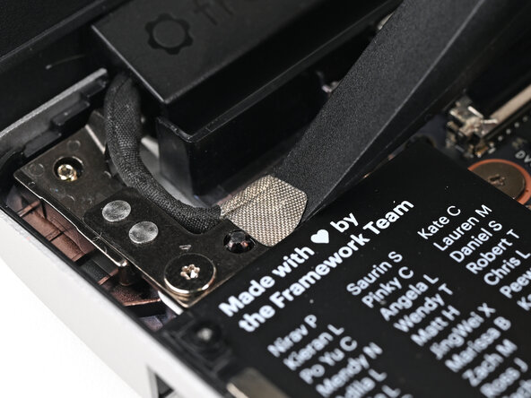

    4. Framework Laptop 13 Pro Bottom Cover Upgrade Kit, Separate the grounding tape: step 13, image 1 of 2 Framework Laptop 13 Pro Bottom Cover Upgrade Kit, Separate the grounding tape: step 13, image 2 of 2
      • Use the flat end of your Framework Screwdriver to peel off the grounding tape on the left Hinge.

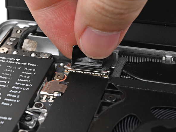

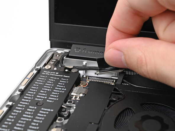

    5. Framework Laptop 13 Pro Bottom Cover Upgrade Kit, Disconnect the Display eDP Cable: step 14, image 1 of 2 Framework Laptop 13 Pro Bottom Cover Upgrade Kit, Disconnect the Display eDP Cable: step 14, image 2 of 2
      • Grip the Display eDP Cable connector by its pull tab and lift up to disconnect it.
      Ask FixBot

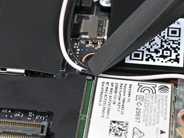

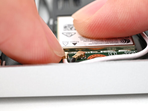

    8. Framework Laptop 13 Pro Bottom Cover Upgrade Kit, Lift the Antenna Cables: step 17, image 1 of 3 Framework Laptop 13 Pro Bottom Cover Upgrade Kit, Lift the Antenna Cables: step 17, image 2 of 3 Framework Laptop 13 Pro Bottom Cover Upgrade Kit, Lift the Antenna Cables: step 17, image 3 of 3
      • Use your fingers or the flat end of the Framework Screwdriver to lift the two Antenna Cables out of their clips on the Mainboard.
      Ask FixBot

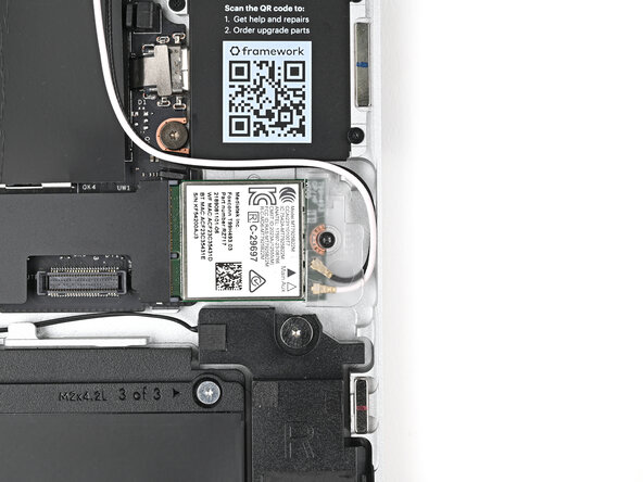

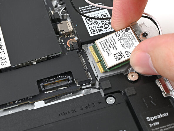

    9. Framework Laptop 13 Pro Bottom Cover Upgrade Kit, Loosen the Wi-Fi module screw: step 18, image 1 of 2 Framework Laptop 13 Pro Bottom Cover Upgrade Kit, Loosen the Wi-Fi module screw: step 18, image 2 of 2
      • Use your Framework Screwdriver to loosen the captive T5 Torx screw securing the Wi-Fi module.
      • The module might pop up at a shallow angle when you loosen the screw.
      Ask FixBot
    10. Framework Laptop 13 Pro Bottom Cover Upgrade Kit, Disconnect the Wi-Fi module: step 19, image 1 of 3 Framework Laptop 13 Pro Bottom Cover Upgrade Kit, Disconnect the Wi-Fi module: step 19, image 2 of 3 Framework Laptop 13 Pro Bottom Cover Upgrade Kit, Disconnect the Wi-Fi module: step 19, image 3 of 3
      • Grip the end of the Wi-Fi module with the screw hole and slide it out of its socket.
      • Don't pull the module too far from its socket, as it's still connected by two cables.
      • Keep the plastic bracket attached to the module to prevent the cables from disconnecting.
      • Position the Wi-Fi module to the right of the laptop to keep it out of the way of the Mainboard.
      Ask FixBot

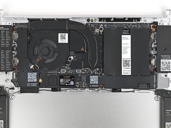

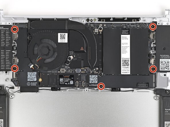

    11. Framework Laptop 13 Pro Bottom Cover Upgrade Kit, Remove the Mainboard screws: step 20, image 1 of 2 Framework Laptop 13 Pro Bottom Cover Upgrade Kit, Remove the Mainboard screws: step 20, image 2 of 2
      • Use your Framework Screwdriver to remove the five 1.5 mm‑long T5 Torx screws securing the Mainboard.
      • Since these screws aren't captive, put them in a safe place.
      Ask FixBot

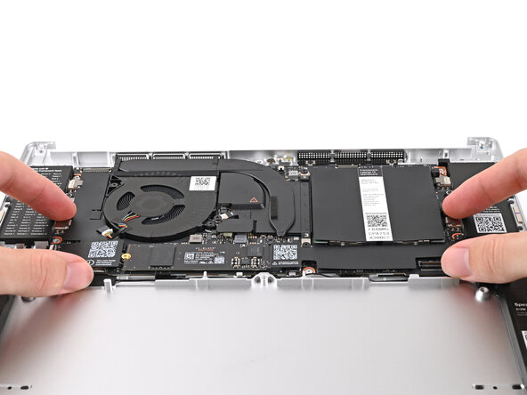

    12. Framework Laptop 13 Pro Bottom Cover Upgrade Kit, Remove the Mainboard: step 21, image 1 of 3 Framework Laptop 13 Pro Bottom Cover Upgrade Kit, Remove the Mainboard: step 21, image 2 of 3 Framework Laptop 13 Pro Bottom Cover Upgrade Kit, Remove the Mainboard: step 21, image 3 of 3
      • Use your fingers to lift the bottom edge of the Mainboard enough to grip its edges.
      • Lift the Mainboard off its alignment pegs and remove it.
      Ask FixBot

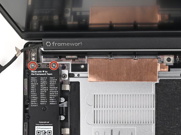

    1. Framework Laptop 13 Pro Bottom Cover Upgrade Kit, Remove the Hinge screws: step 22, image 1 of 3 Framework Laptop 13 Pro Bottom Cover Upgrade Kit, Remove the Hinge screws: step 22, image 2 of 3 Framework Laptop 13 Pro Bottom Cover Upgrade Kit, Remove the Hinge screws: step 22, image 3 of 3
      • While supporting the Top Cover with one hand, use your Framework Screwdriver to remove two 4.0 mm‑long T5 Torx screws on each Hinge connected to the Bottom Cover (four total).

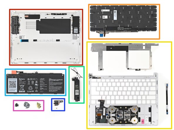

    1. Framework Laptop 13 Pro Bottom Cover Upgrade Kit, Unbox your Bottom Cover Upgrade Kit: step 24, image 1 of 2 Framework Laptop 13 Pro Bottom Cover Upgrade Kit, Unbox your Bottom Cover Upgrade Kit: step 24, image 2 of 2
      • Unbox your Bottom Cover Upgrade Kit and make sure you've received the following items:
      • Bottom Cover Kit
      • Keyboard
      • Input Cover Frame (including the Keyboard Bracket and Fingerprint Reader Cable)
      • Speaker Kit
      • Battery
      • Audio Board Kit
      • Fastener Kit – Input Cover and Keyboard (only the Keyboard and Keyboard Bracket screws are needed—the rest can be kept as spares)

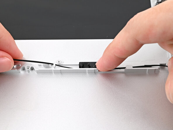

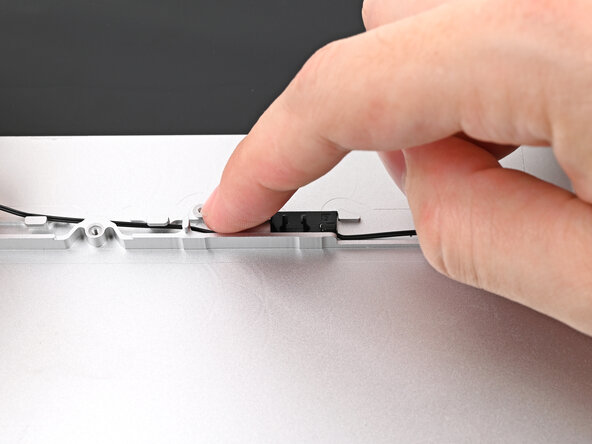

    6. Framework Laptop 13 Pro Bottom Cover Upgrade Kit, Route the Speaker Cables: step 29, image 1 of 3 Framework Laptop 13 Pro Bottom Cover Upgrade Kit, Route the Speaker Cables: step 29, image 2 of 3 Framework Laptop 13 Pro Bottom Cover Upgrade Kit, Route the Speaker Cables: step 29, image 3 of 3
      • Starting from the right Speaker, press the speaker cable into its metal and plastic clips on the Bottom Cover.
      • Pull the cable taut against the Bottom Cover as you do this, as you'll need slack along the left edge.
      Ask FixBot
    7. Framework Laptop 13 Pro Bottom Cover Upgrade Kit: step 30, image 1 of 2 Framework Laptop 13 Pro Bottom Cover Upgrade Kit: step 30, image 2 of 2
      • If you're having difficulty pressing the speaker cable into its plastic clips, twist the cable so it's vertical and use the flat end of your Framework Screwdriver to press it down.
      Ask FixBot

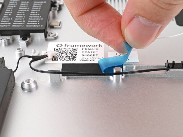

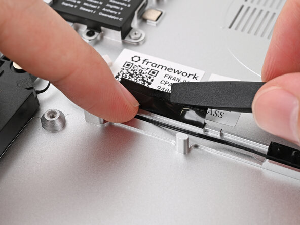

    9. Framework Laptop 13 Pro Bottom Cover Upgrade Kit, Remove the liner: step 32, image 1 of 3 Framework Laptop 13 Pro Bottom Cover Upgrade Kit, Remove the liner: step 32, image 2 of 3 Framework Laptop 13 Pro Bottom Cover Upgrade Kit, Remove the liner: step 32, image 3 of 3
      • Remove the blue liner from the black tape near the left Speaker.
      Ask FixBot
    10. Framework Laptop 13 Pro Bottom Cover Upgrade Kit, Separate the tape: step 33, image 1 of 3 Framework Laptop 13 Pro Bottom Cover Upgrade Kit, Separate the tape: step 33, image 2 of 3 Framework Laptop 13 Pro Bottom Cover Upgrade Kit, Separate the tape: step 33, image 3 of 3
      • Slide the flat end of your Framework Screwdriver under the black tape and separate one of its long edges from the Chassis.
      Ask FixBot
    11. Framework Laptop 13 Pro Bottom Cover Upgrade Kit, Adhere the Speaker Cable: step 34, image 1 of 3 Framework Laptop 13 Pro Bottom Cover Upgrade Kit, Adhere the Speaker Cable: step 34, image 2 of 3 Framework Laptop 13 Pro Bottom Cover Upgrade Kit, Adhere the Speaker Cable: step 34, image 3 of 3
      • While holding the tape out of the way, lay the Speaker Cable into the channel underneath it.
      • Press the tape over the Speaker Cable to adhere it to the Chassis.
      Ask FixBot

    13. Framework Laptop 13 Pro Bottom Cover Upgrade Kit, Place the Mainboard: step 36, image 1 of 2 Framework Laptop 13 Pro Bottom Cover Upgrade Kit, Place the Mainboard: step 36, image 2 of 2
      • Grab the Mainboard by its edges and place it into the Bottom Cover and onto its alignment pegs.
      Ask FixBot
    14. Framework Laptop 13 Pro Bottom Cover Upgrade Kit, Install the Mainboard screws: step 37, image 1 of 2 Framework Laptop 13 Pro Bottom Cover Upgrade Kit, Install the Mainboard screws: step 37, image 2 of 2
      • Use your Framework Screwdriver to install the five 1.5 mm‑long T5 Torx screws securing the Mainboard.
      Ask FixBot

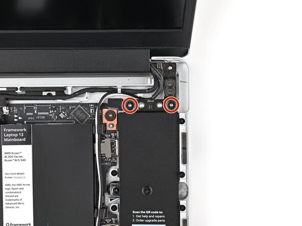

    20. Framework Laptop 13 Pro Bottom Cover Upgrade Kit, Install the Hinge screws: step 43, image 1 of 3 Framework Laptop 13 Pro Bottom Cover Upgrade Kit, Install the Hinge screws: step 43, image 2 of 3 Framework Laptop 13 Pro Bottom Cover Upgrade Kit, Install the Hinge screws: step 43, image 3 of 3
      • While supporting the Top Cover with one hand, use your Framework Screwdriver to install two 4.0 mm‑long T5 Torx screws on each Hinge connected to the Bottom Cover (four total).

    23. Framework Laptop 13 Pro Bottom Cover Upgrade Kit, Adhere the grounding tape: step 46, image 1 of 2 Framework Laptop 13 Pro Bottom Cover Upgrade Kit, Adhere the grounding tape: step 46, image 2 of 2
      • Press the grounding tape onto the left Hinge to adhere it.

    24. Framework Laptop 13 Pro Bottom Cover Upgrade Kit, Connect the Audio Board: step 47, image 1 of 2 Framework Laptop 13 Pro Bottom Cover Upgrade Kit, Connect the Audio Board: step 47, image 2 of 2
      • Slide the Audio Board cable straight into its socket.
      Ask FixBot
    25. Framework Laptop 13 Pro Bottom Cover Upgrade Kit: step 48, image 1 of 2 Framework Laptop 13 Pro Bottom Cover Upgrade Kit: step 48, image 2 of 2
      • Use the flat end of your Framework Screwdriver, or a clean fingernail, to press down the locking tab on the Audio Board ZIF connector.
      Ask FixBot
    26. Framework Laptop 13 Pro Bottom Cover Upgrade Kit, Connect the Speakers: step 49, image 1 of 2 Framework Laptop 13 Pro Bottom Cover Upgrade Kit, Connect the Speakers: step 49, image 2 of 2
      • Slide the Speaker connector straight into its socket.

    27. Framework Laptop 13 Pro Bottom Cover Upgrade Kit, Reroute the Webcam Cable: step 50, image 1 of 3 Framework Laptop 13 Pro Bottom Cover Upgrade Kit, Reroute the Webcam Cable: step 50, image 2 of 3 Framework Laptop 13 Pro Bottom Cover Upgrade Kit, Reroute the Webcam Cable: step 50, image 3 of 3
      • Use your finger to guide the Webcam Cable into its metal pegs on the Bottom Cover.
      • Refer to this photo for how the cable should look when properly routed.
      Ask FixBot
    28. Framework Laptop 13 Pro Bottom Cover Upgrade Kit, Connect the Webcam Cable: step 51, image 1 of 2 Framework Laptop 13 Pro Bottom Cover Upgrade Kit, Connect the Webcam Cable: step 51, image 2 of 2
      • Press the Webcam Cable connector straight down into its socket to connect it.
      Ask FixBot
    29. Framework Laptop 13 Pro Bottom Cover Upgrade Kit, Reroute the Antenna Cables: step 52, image 1 of 3 Framework Laptop 13 Pro Bottom Cover Upgrade Kit, Reroute the Antenna Cables: step 52, image 2 of 3 Framework Laptop 13 Pro Bottom Cover Upgrade Kit, Reroute the Antenna Cables: step 52, image 3 of 3
      • Use your finger to press the Antenna Cables into their metal clip on the Bottom Cover.
      • Rotate the cables around the raised corner at the top right of the Mainboard so they point towards the Wi-Fi module.
      • Refer to this photo for how the cables should look when properly routed.

    32. Framework Laptop 13 Pro Bottom Cover Upgrade Kit, Install the Wi-Fi module: step 55, image 1 of 2 Framework Laptop 13 Pro Bottom Cover Upgrade Kit, Install the Wi-Fi module: step 55, image 2 of 2
      • Hold the Wi-Fi module by its edges. Don't touch the gold contacts with your fingers. If you do, wipe the contacts with a clean, lint-free cloth to remove any finger oils.
      • Align the Wi-Fi module's gold contacts and notch with the socket on the Mainboard.
      • Insert the Wi-Fi module into the socket at a shallow angle. The gold contacts should mostly be covered by the socket.
      • The Wi-Fi module fits into the socket in one orientation. If it doesn't fit, try flipping the module.
      Ask FixBot
    33. Framework Laptop 13 Pro Bottom Cover Upgrade Kit, Reconnect the Wi-Fi module: step 56, image 1 of 3 Framework Laptop 13 Pro Bottom Cover Upgrade Kit, Reconnect the Wi-Fi module: step 56, image 2 of 3 Framework Laptop 13 Pro Bottom Cover Upgrade Kit, Reconnect the Wi-Fi module: step 56, image 3 of 3
      • If the Antenna Cables got accidentally disconnected, follow this step to reconnect them. Otherwise, skip this step to continue the guide normally.
      • Hold the Wi-Fi module down with your finger.
      • Position the black antenna cable connector over the Wi-Fi module's coaxial socket indicated by the black arrow.
      • If you're unsure which cable goes where, refer to the arrows on the Wi-Fi module for which color cable matches with its connector.
      • Tweezers can help position the connector.
      • Use your finger to press the connector into place. You should feel a faint click, and the cable will stay attached to the socket by itself.
      • These connectors are very delicate! If the connector doesn't feel like it's clicking in place, reposition the connector and try again.
      • Repeat the procedure with the white antenna cable.
      Ask FixBot
    34. Framework Laptop 13 Pro Bottom Cover Upgrade Kit, Tighten the Wi-Fi module screw: step 57, image 1 of 2 Framework Laptop 13 Pro Bottom Cover Upgrade Kit, Tighten the Wi-Fi module screw: step 57, image 2 of 2
      • Use your Framework Screwdriver to tighten the captive T5 Torx screw securing the Wi-Fi module.
      Ask FixBot
    35. Framework Laptop 13 Pro Bottom Cover Upgrade Kit, Reroute the Antenna Cables: step 58, image 1 of 3 Framework Laptop 13 Pro Bottom Cover Upgrade Kit, Reroute the Antenna Cables: step 58, image 2 of 3 Framework Laptop 13 Pro Bottom Cover Upgrade Kit, Reroute the Antenna Cables: step 58, image 3 of 3
      • Use the flat end of your Framework Screwdriver to press the two Antenna Cables into their rubber clips on the Mainboard.

    36. Framework Laptop 13 Pro Bottom Cover Upgrade Kit, Reconnect the Battery: step 59, image 1 of 2 Framework Laptop 13 Pro Bottom Cover Upgrade Kit, Reconnect the Battery: step 59, image 2 of 2
      • Use your fingers to align the Battery connector with its socket and slide it straight in to reconnect the Battery.
      Ask FixBot

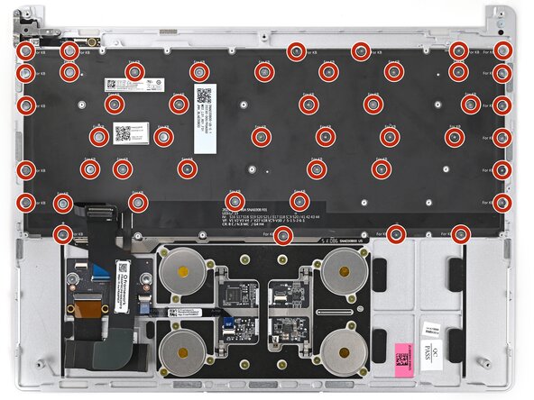

    37. Framework Laptop 13 Pro Bottom Cover Upgrade Kit, Place the Keyboard: step 60, image 1 of 2 Framework Laptop 13 Pro Bottom Cover Upgrade Kit, Place the Keyboard: step 60, image 2 of 2
      • Place the Keyboard into its cutout in the Top Cover.
      Ask FixBot
    38. Framework Laptop 13 Pro Bottom Cover Upgrade Kit, Install the Keyboard screws: step 61, image 1 of 2 Framework Laptop 13 Pro Bottom Cover Upgrade Kit, Install the Keyboard screws: step 61, image 2 of 2
      • Use your Framework Screwdriver to install the forty-six 1.2 mm‑long black PH0 screws securing the Keyboard.
      • The screw holes for the Keyboard are labeled with "KB" and an arrow pointing to them.
      Ask FixBot
    39. Framework Laptop 13 Pro Bottom Cover Upgrade Kit, Place the Keyboard Bracket: step 62, image 1 of 3 Framework Laptop 13 Pro Bottom Cover Upgrade Kit, Place the Keyboard Bracket: step 62, image 2 of 3 Framework Laptop 13 Pro Bottom Cover Upgrade Kit, Place the Keyboard Bracket: step 62, image 3 of 3
      • Place the Keyboard Bracket onto its alignment pegs.
      Ask FixBot
    40. Framework Laptop 13 Pro Bottom Cover Upgrade Kit, Install the Keyboard Bracket screws: step 63, image 1 of 2 Framework Laptop 13 Pro Bottom Cover Upgrade Kit, Install the Keyboard Bracket screws: step 63, image 2 of 2
      • Use your Framework Screwdriver to install the twenty 1.3 mm‑long silver PH0 screws securing the Keyboard Bracket.
      Ask FixBot

    45. Framework Laptop 13 Pro Bottom Cover Upgrade Kit, Position the Input Cover: step 68, image 1 of 2 Framework Laptop 13 Pro Bottom Cover Upgrade Kit, Position the Input Cover: step 68, image 2 of 2
      • Your old Input Cover is not compatible—only use the new one.
      • Position the Input Cover, keyboard down, on top of the laptop so it just covers the Battery.
      • This allows the Touchpad Cable to be folded over and reconnected without straining it.

    47. Framework Laptop 13 Pro Bottom Cover Upgrade Kit, Place the Input Cover: step 70, image 1 of 2 Framework Laptop 13 Pro Bottom Cover Upgrade Kit, Place the Input Cover: step 70, image 2 of 2
      • Flip the Input Cover over the laptop and align the bottom edges.
      Ask FixBot
    48. Framework Laptop 13 Pro Bottom Cover Upgrade Kit: step 71, image 1 of 3 Framework Laptop 13 Pro Bottom Cover Upgrade Kit: step 71, image 2 of 3 Framework Laptop 13 Pro Bottom Cover Upgrade Kit: step 71, image 3 of 3
      • Lay the Input Cover over the laptop and let the magnets snap it into place.
      • The bottom right corner of the Input Cover won't sit flush with the laptop until you tighten its screws.
      Ask FixBot
    49. Framework Laptop 13 Pro Bottom Cover Upgrade Kit, Tighten the Input Cover screws: step 72, image 1 of 2 Framework Laptop 13 Pro Bottom Cover Upgrade Kit, Tighten the Input Cover screws: step 72, image 2 of 2
      • Close the laptop and flip it over.
      • Use your Framework Screwdriver to tighten the five captive T5 Torx screws securing the Input Cover.
      • Don't overtighten the screws—just make sure they're snug.

    50. Framework Laptop 13 Pro Bottom Cover Upgrade Kit, Install the Expansion Cards: step 73, image 1 of 3 Framework Laptop 13 Pro Bottom Cover Upgrade Kit, Install the Expansion Cards: step 73, image 2 of 3 Framework Laptop 13 Pro Bottom Cover Upgrade Kit, Install the Expansion Cards: step 73, image 3 of 3
      • For Expansion Card compatibility, check here.
      • Slide an Expansion Card into an Expansion Card slot.
      • You don't need to unlock the latch to install the Expansion Cards—only when you want to remove them.
      • The Expansion Cards should click into place, and the front edge should be flush with the laptop.
      • Repeat for the remaining Expansion Cards.

    51. Framework Laptop 13 Pro Bottom Cover Upgrade Kit: step 74, image 1 of 2 Framework Laptop 13 Pro Bottom Cover Upgrade Kit: step 74, image 2 of 2
      • Use your finger to flip both latches and lock the rows of Expansion Cards.
      Ask FixBot
