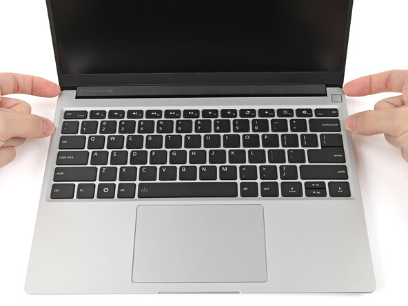

    2. Framework Laptop 13 Memory Replacement, Lift the Input Cover: step 3, image 1 of 2 Framework Laptop 13 Memory Replacement, Lift the Input Cover: step 3, image 2 of 2
      • Flip over your laptop and open it.
      • Use your fingers to lift the Input Cover up and release it from its magnets.
      • Don't fully remove the Input Cover yet, as it's still attached by the Touchpad Cable.

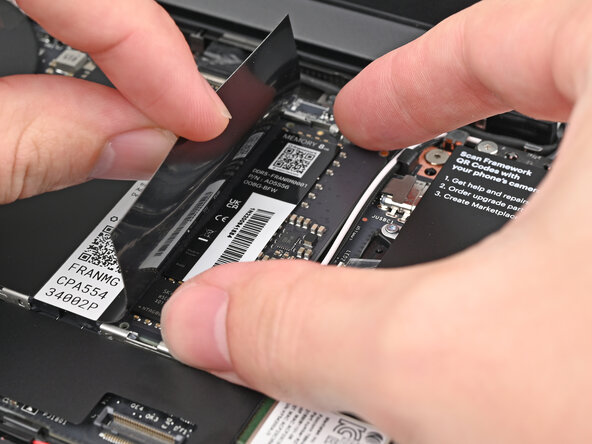

    1. Framework Laptop 13 Memory Replacement, Remove the memory: step 7, image 1 of 3 Framework Laptop 13 Memory Replacement, Remove the memory: step 7, image 2 of 3 Framework Laptop 13 Memory Replacement, Remove the memory: step 7, image 3 of 3
      • Depending on your Mainboard's generation, you might not have black flaps covering your memory.
      • While holding up the black flap covering the left memory module, push the two metal arms on each side of the module outward until they disengage and the module pops up at a shallow angle.
      • Slide the memory module out of its socket and remove it.
      Ask FixBot
