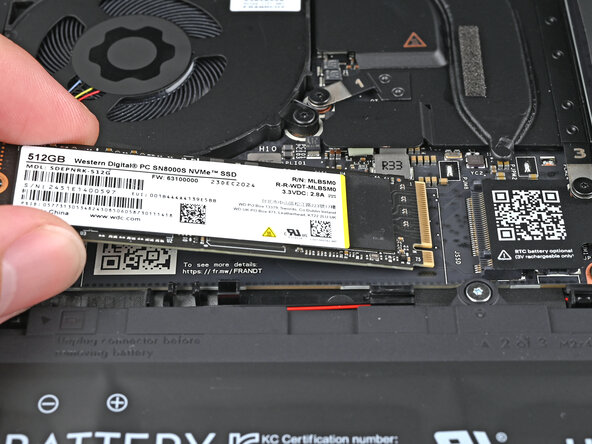

    7. Framework Laptop 13 DIY Edition Quick Start Guide, Install the SSD: step 7, image 1 of 2 Framework Laptop 13 DIY Edition Quick Start Guide, Install the SSD: step 7, image 2 of 2
      • Hold the SSD by its edges. Don't touch the gold contacts with your fingers. If you do, wipe the contacts with a clean, lint-free cloth to remove any finger oils.
      • Insert the SSD into the socket at a shallow angle. The gold contacts should mostly be covered by the socket.
      • The SSD fits into the socket in one orientation. If it doesn't feel like it fits, try flipping the module.
      Ask FixBot
    8. Framework Laptop 13 DIY Edition Quick Start Guide, Install the SSD screw: step 8, image 1 of 3 Framework Laptop 13 DIY Edition Quick Start Guide, Install the SSD screw: step 8, image 2 of 3 Framework Laptop 13 DIY Edition Quick Start Guide, Install the SSD screw: step 8, image 3 of 3
      • While holding the SSD flat to the Mainboard, use your Framework Screwdriver to install the 3.0 mm‑long T5 Torx screw securing the SSD.

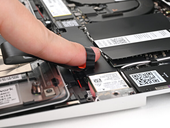

    10. Framework Laptop 13 DIY Edition Quick Start Guide, Connect the Touchpad Cable: step 10, image 1 of 2 Framework Laptop 13 DIY Edition Quick Start Guide, Connect the Touchpad Cable: step 10, image 2 of 2
      • Insert your finger into the Touchpad Cable press connector loop.
      • Align the press connector over its socket and press down with your finger.
      • You should hear it "click" into place. Don't try to force the connector into place. If you're having trouble, reposition it and try again.

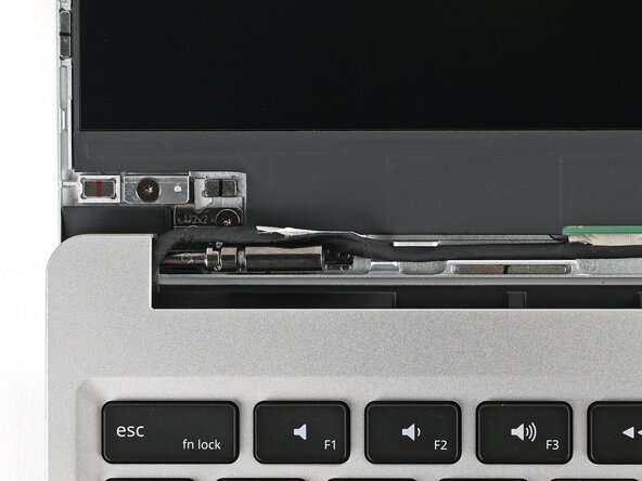

    14. Framework Laptop 13 DIY Edition Quick Start Guide, Check the cables: step 14, image 1 of 3 Framework Laptop 13 DIY Edition Quick Start Guide, Check the cables: step 14, image 2 of 3 Framework Laptop 13 DIY Edition Quick Start Guide, Check the cables: step 14, image 3 of 3
      • Before continuing, check if cables next to the hinges are routed properly:
      • The Display Cable should be routed just above the hinge without any large gaps.
      • Your Display Cable might come with a white sticker. This doesn't affect the routing.
      • The Display Cable should be routed between the metal clips.
      • The Webcam Cable should be routed just above the hinge without any large gaps and shouldn't overlap with the antenna cables.
      • If the cables aren't routed properly, the Bezel won't sit flat and you risk damaging the Bezel and the Display during reassembly.
