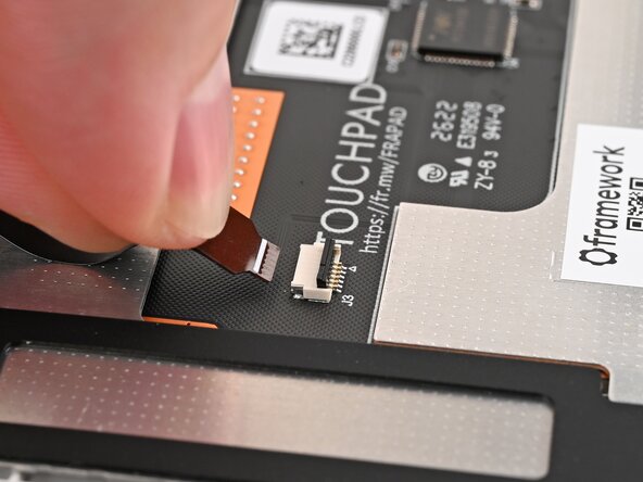

    1. Framework Laptop 12 Touchpad Removal [Updated], Disconnect the touchpad: step 7, image 1 of 3 Framework Laptop 12 Touchpad Removal [Updated], Disconnect the touchpad: step 7, image 2 of 3 Framework Laptop 12 Touchpad Removal [Updated], Disconnect the touchpad: step 7, image 3 of 3
      • Use the flat end of your Framework Screwdriver or a fingernail to gently pry up the black locking tab on the touchpad cable ZIF connector, located on the back of the touchpad.
      Ask FixBot
    2. Framework Laptop 12 Touchpad Removal [Updated]: step 8, image 1 of 2 Framework Laptop 12 Touchpad Removal [Updated]: step 8, image 2 of 2
      • Grab the touchpad cable by the brown tab and slide it out of its connector.
