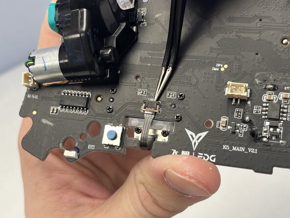

      • Lift the latch that retains the right joystick flex cable.
      • Gently pull the cable away from the connector.

    7. Flydigi Apex 5 Joystick Modules Replacement: step 18, image 1 of 3 Flydigi Apex 5 Joystick Modules Replacement: step 18, image 2 of 3 Flydigi Apex 5 Joystick Modules Replacement: step 18, image 3 of 3
      Ask FixBot

NOTE: The flex cables have a line on the side opposing their contacts. This line indicates when the cable is properly seated in the connector. The line should be flush with or hidden by the connector.
