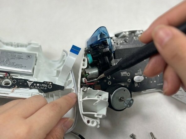

    5. Flydigi Apex 4 Trigger Assembly Replacement: step 5, image 1 of 3 Flydigi Apex 4 Trigger Assembly Replacement: step 5, image 2 of 3 Flydigi Apex 4 Trigger Assembly Replacement: step 5, image 3 of 3
      • Use a spudger or your fingernail to gently flip up the locking tab on the connector linking the trigger assembly to the main PCB.
      • Carefully pull the ribbon cable straight out of the connector.
      • Do not pull at an angle, as this may tear the cable.
      Ask FixBot
