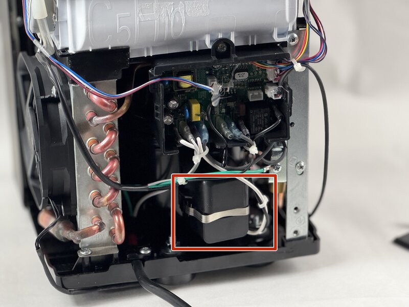

    1. Euhomy IM-06D Compressor Relay Replacement, Compressor Relay: step 6, image 1 of 3 Euhomy IM-06D Compressor Relay Replacement, Compressor Relay: step 6, image 2 of 3 Euhomy IM-06D Compressor Relay Replacement, Compressor Relay: step 6, image 3 of 3
      • Locate the black box under the green ground cable and find the silver clip running across the back of it.
      • Use a pry tool remove the clip.
      • Remove the box.
      Ask FixBot
