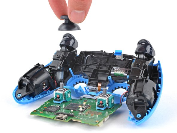

    11. DualSense Controller v2 Joystick Cover Replacement, Lift out the motherboard: step 25, image 1 of 3 DualSense Controller v2 Joystick Cover Replacement, Lift out the motherboard: step 25, image 2 of 3 DualSense Controller v2 Joystick Cover Replacement, Lift out the motherboard: step 25, image 3 of 3
      • Carefully guide the joysticks through the front case and lift the motherboard out.
      • Don't strain the four soldered wires tethering the motherboard to the vibration motors.
      Ask FixBot
    1. DualSense Controller v2 Joystick Cover Replacement, Remove the joystick covers: step 26, image 1 of 3 DualSense Controller v2 Joystick Cover Replacement, Remove the joystick covers: step 26, image 2 of 3 DualSense Controller v2 Joystick Cover Replacement, Remove the joystick covers: step 26, image 3 of 3
      • Use your fingers to pull the joystick covers straight up and off of their modules.
