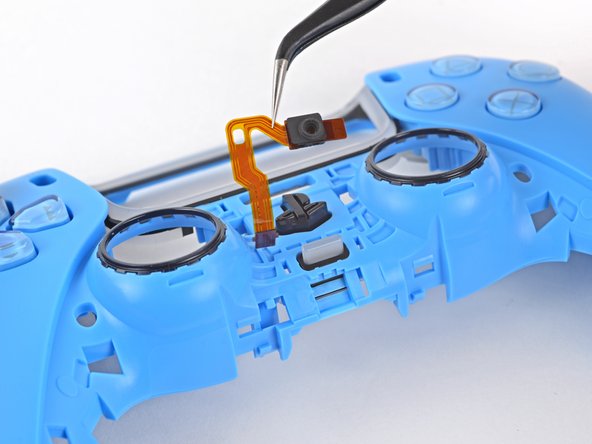

    2. DualSense Controller v2 Front Case Replacement: step 33, image 1 of 3 DualSense Controller v2 Front Case Replacement: step 33, image 2 of 3 DualSense Controller v2 Front Case Replacement: step 33, image 3 of 3
      Tool used on this step:
      Buy
      • Use a pair of tweezers to carefully thread the microphone cable out through the front case.
      • Don't force the cable if you encounter resistance. It may have snagged on the front case.
      • Remove the microphone.
      • During reinstallation, verify that the microphone cable is properly seated in its retaining clips in the front case.

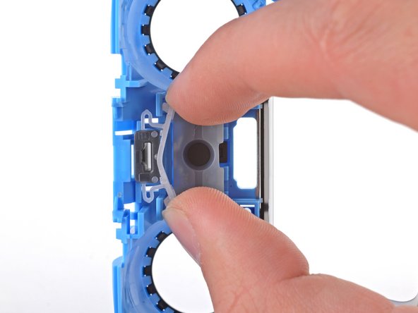

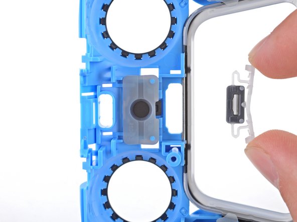

    3. DualSense Controller v2 Front Case Replacement: step 34, image 1 of 3 DualSense Controller v2 Front Case Replacement: step 34, image 2 of 3 DualSense Controller v2 Front Case Replacement: step 34, image 3 of 3
      • Use your fingers to lightly pinch the plastic clip securing the microphone mute button to the front case and remove it.
      Ask FixBot

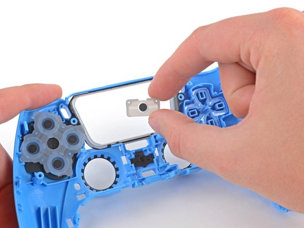

    4. DualSense Controller v2 Front Case Replacement: step 35, image 1 of 3 DualSense Controller v2 Front Case Replacement: step 35, image 2 of 3 DualSense Controller v2 Front Case Replacement: step 35, image 3 of 3
      • Remove the three conductive silicone rubber pads from the inside of the front case.
      • The remaining buttons are now resting loose in the front case.
      Ask FixBot

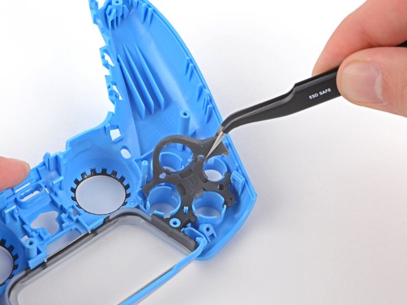

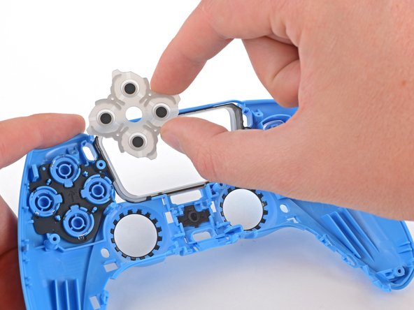

    5. DualSense Controller v2 Front Case Replacement: step 36, image 1 of 3 DualSense Controller v2 Front Case Replacement: step 36, image 2 of 3 DualSense Controller v2 Front Case Replacement: step 36, image 3 of 3
      • Hold the front case close to the surface of your table and slowly turn the front case over to let the buttons fall out.
      • Reassembly note: the buttons are designed to be impossible to install incorrectly. Do not force any buttons into place—they will fall into place when positioned correctly.
      Ask FixBot

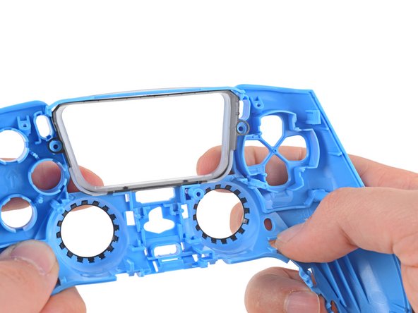

    7. DualSense Controller v2 Front Case Replacement: step 38, image 1 of 3 DualSense Controller v2 Front Case Replacement: step 38, image 2 of 3 DualSense Controller v2 Front Case Replacement: step 38, image 3 of 3
      • Use your fingers to press the touchpad bezel out through the inside of the front case.
      Ask FixBot
