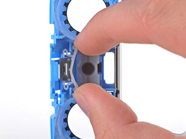

    1. DualSense Controller v2 Button Replacement, Remove the Select/Start buttons: step 29, image 1 of 3 DualSense Controller v2 Button Replacement, Remove the Select/Start buttons: step 29, image 2 of 3 DualSense Controller v2 Button Replacement, Remove the Select/Start buttons: step 29, image 3 of 3
      • Remove the Select and Start buttons from the front case.
      Ask FixBot
    2. DualSense Controller v2 Button Replacement, Remove the Mute button: step 30, image 1 of 3 DualSense Controller v2 Button Replacement, Remove the Mute button: step 30, image 2 of 3 DualSense Controller v2 Button Replacement, Remove the Mute button: step 30, image 3 of 3
      • Use your fingers to lightly pinch the plastic clip securing the microphone mute button to the front case and remove it.
      Ask FixBot

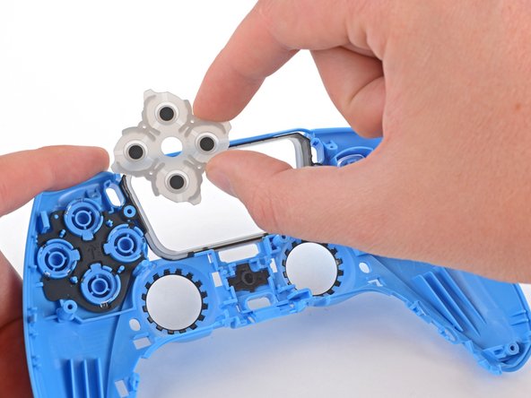

    3. DualSense Controller v2 Button Replacement, Remove the conductive silicone: step 31, image 1 of 3 DualSense Controller v2 Button Replacement, Remove the conductive silicone: step 31, image 2 of 3 DualSense Controller v2 Button Replacement, Remove the conductive silicone: step 31, image 3 of 3
      • Remove the three conductive silicone rubber pads from the inside of the front case.
      • The remaining buttons are now resting loose in the front case.
      Ask FixBot
    4. DualSense Controller v2 Button Replacement, Remove the buttons: step 32, image 1 of 3 DualSense Controller v2 Button Replacement, Remove the buttons: step 32, image 2 of 3 DualSense Controller v2 Button Replacement, Remove the buttons: step 32, image 3 of 3
      • Hold the front case close to the surface of your table and slowly turn the front case over to let the buttons fall out.
      • The buttons are designed to be impossible to install incorrectly. Do not force any buttons into place—they will fall into place when positioned correctly.
      Ask FixBot
